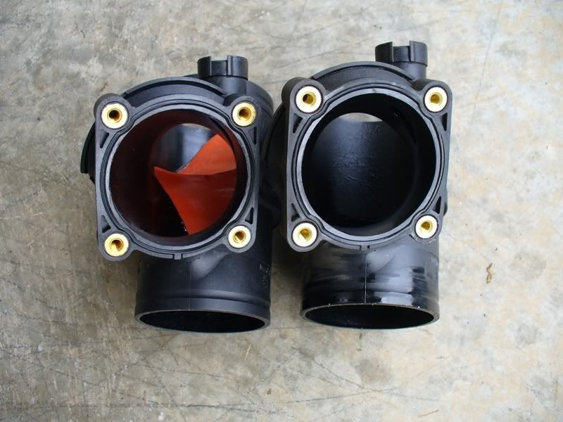

Originally Posted by sb01box
I went on the web for boxster engine and found what was titled as 2007 S engine.
the drawing shows a cutaway view of the intake plenum.
there appears to be left/right fence on the main tube and what I am suspecting as a split butterfly plate that adjusts the angle with air speed?? pic attached
if so, Techno Torque features are quite in-line with latest boxster engine intake design!

Since my motor is out being rebuilt, I have been looking at the parts discussed here and have a bit of time to investigate some "upgrades". I looked at the intake plenum I have, Part #996.110.055.00 and was wondering if one from a "newer" Boxster would be a direct replacement? Friend of mine has an Independant P-Car shop who can order parts for me at his price ....
I was wandering down the same road a while back. looking at the parts list, the 987 intake has vaccum/electronically controlled butterfly in the intake "T" that the ECU manipulates. as such I doubt that it is a direct drop in replacement.
On a side note, as for AOS, the 987 part can be fit into 986, replacing the plumbing from the AOS to the intake behind the throttle body (986 has one tubing, 987 has split two tubes) should suffice here.
I do not qualify even as a weekend mechanic, anyone having knowledge please chime in.

The 02's seems to be controlled the same. The T is attached to the "butterfly" unit with a few longer bolts. Thought someone here may have some experiance on this.
I had thought that up to 03, the intake "T" plumbing are the same and that after 987 series the intake "T" has the internal baffling/routing just behind the throttle body and the controlled butterfly at the "T". this is not the same as the throttle body butterfly.
picture shows the baffling/routing along with butterfly at the junction

It's king of hard to compare both systems in any of the drawings I have seen. maybe someone who has worked on both can add to the discussion.
picture below shows side by side of the intake plenum. the part that I was focusing in is the additional butterfly in the plenum in the "T".
it's opeation is controlled by electronics and vacuum. I don't think 986 ECU has this feature and therefore compatibility problem
Thanks ... one can see that they are not compatible. Was hoping though ....

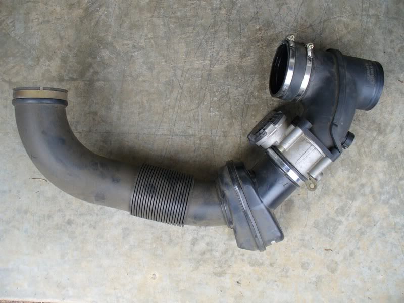

Just cleaned my throttle body and installed my Techno Torque2. I haven't quite buttoned up everything so I haven't yet driven it.
Does anyone know the purpose of the oddly shaped piece on the tube from the air box to the throttle body? It is close to the throttle body end.
Thanks,
