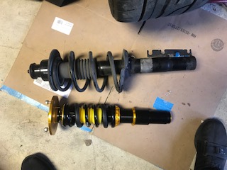

Is this a problem?
Pulled the rear struts moments ago and looking at them side by side. The new strut is MUCH shorter and doesn't have the mounts for my antilock brake sensor and brake wear indicator wires. The strut didnt stick out the bottom like the fronts...this is wrong!
reviewing ECSY post earlier in this thread (he bought the same coilovers) calms my nerves a little as he shows his rear and the new side-by-side and they look the same, but what about the wires?
Sanity check?

Location: Houston
Posts: 221
Im using yellow speed easy inch lower than stock not a bad ride.

Old 06-12-2020, 04:36 PM   #35

What about the wires?
Were there any clips or anything with the kit? Ohlins provide some that slip around the strut body and so did KSport, their style sandwiches in between the drop link pinch bolt. There may be 3rd party versions available.
For the height, it probably doesn't compress as far as the very soft OEM setup so loaded up it probably won't be as extreme as it looks in the unloaded state.

Will there be cake?
of course, no clips. You might be right about the compression, time will tell when I drop the car.

dropped the car and everything looks fine...about 1/2 inch (13mm) lower which I planned for, barely noticeable. Car drives GREAT! night and day. No pitching in the turns, it stays flat, responds to the steering wheel immediately and feels really tight. This is the most significant change I have ever made.
