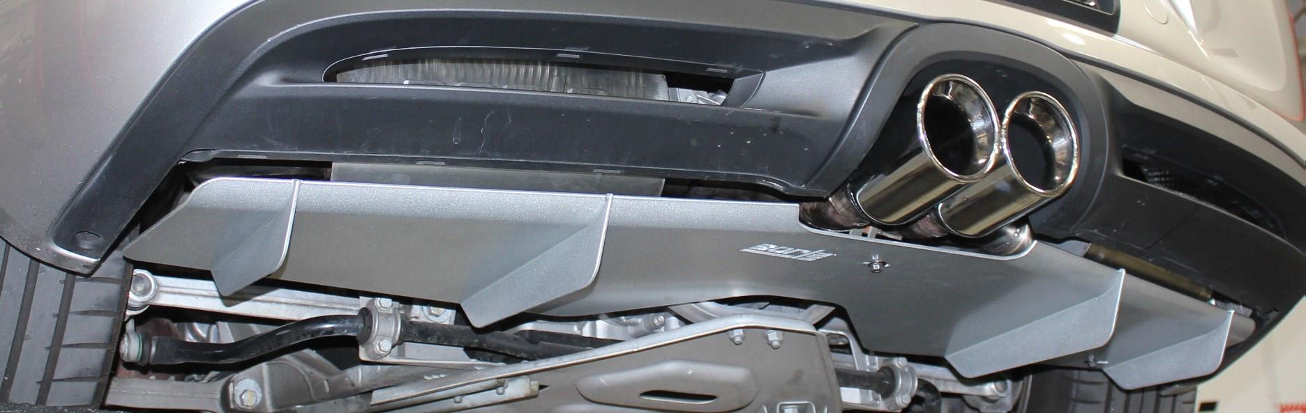

do you think this would fit on a 986?
Diffuser (Metal) for 2014+ Porsche Cayman/S Boxster/S [981] by Borla (77013)

No, because the rear fascia (read bumper cover) is shaped differently on the 986.

yeah, i am aware of that, as well as the difference pre- and post-facelift on the 986 rear bumper cover. I am not looking for a direct OEM-style fit, but whether if it could be made to fit. 986 and 981 overall width difference is only +/- 1/2", and the 981 borla muffler to which it mounts (i don't think it needs to attach to the bodywork) looks pretty similar to the knock-off aftermarket muffler i have on my 986, so thinking it could be hung off the back with just a bit of messing around. not much else out there for rear diffusers for the 986 except for gt3tek (and it appears to be more cosmetic and aerodynamic).

I believe it might be made to fit. Looks convincing. Thanks for sharing it with us

It could fit, but I think some cutting will be necessary to either the rear bumper or the diffuser itself. Another question to ask is "Will it work?" From what I understand, the diffuser really needs to extend in front of the rear wheels to get the flow. That diffuser looks kinda short.
+1 on the above, it needs another dam at the wheels to prevent air from being pulled in from the wheel wells. Further would need to add a front splitter to control air under the car, but it's all for naught since those darned radiators dump all that air under the car! I do like the bernoulli curve on the GT3 Tek better though.

well, if you look at the install manual, the diffuser appears to mate relatively well with the tray under the transmission. between the two of them it gets the underneath of the car pretty well covered, except where you need to leave room for the suspension to do its stuff.

well, the hope was no bodywork - that the arse end of the 981 is wider than the 986 so that the diffuser would fit inside the bumper cover with no trimming. the diffuser appears to attach at three places on the muffler so it would hang suspended from that with no body contact.
i could buy this:
Aluminum Utility Sheet 3003-H14 1/8 .125" x 24" x 36" | eBay
and these:
Dodge Viper 6 Rear Fins / Diffusers | eBay
and three exhaust hangers. i could make a template out of cardboard, cut-out the sheet alu, roll the rear lip (i have a friend with a sheet metal roller) fasten the fins and hang from the exhaust. thing is, with shipping i would be looking at $300 just in material. given that time is money, it would be nice to just buy something.

Now this is a decent design!
