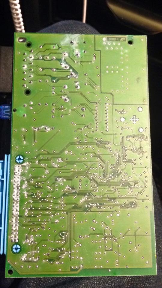

well, let's hope this hasn't caused any permanent damage... I've had luck with electronics (even motherboards) in the past when it comes to this stuff... just hope it is not FUBAR...
What a stupid place to put this thing. Is it common to drill holes underneath it?

Er, did not realize we can just attach photos..
I want to blame the mitsubishi chip on the board just out of spite from owning DSMs in the past.
Going to give it the toothbrush + iso treatment and a little dry heat.
hopefully I can at least get the car to start again even if I lose some function. Would be nice to be able to drive it to my garage rather than deal with current situation.
I've already read what a nightmare this is to fix from a financial standpoint... There still isn't a relatively easy bypass for this to get the DME to start the car? In hindsight I should have put the top back up before removing this thing.

Cleaned it with ISO alcohol, let it dry, blew it off with duster, let it dry
hooked it up, nothing works except "click-click" and two beeps when i hit the keyfob (either button)
Now I am unable to use the windows or anything.. car still keys on.. dash, hvac, radio, etc.. all the accessories work except the ones tied to the CLU (no windows, no top, no start, no lock, but keyfob is still trying to work)
Any ideas? The only thing that happened is i lost the ability to do all the **************** I could before taking it apart/out
