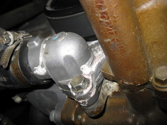

Today, at 113k km (70k miles) I've got this:
There is pink coolant residue on the left side of the pump (looking to the rear of the car) and at the bottom, but none on the right. It doesn't appear to be coming from the pump/engine contact. If it's leaking thru the shaft seal, wouldn't it be on both sides? Is there somewhere above that could be leaking down onto the pump?

The pump has a small "weep hole" in the shaft area, which is where they usually start leaking like yours is doing. Pump time.............

From what ive read,Porsche pumps can weep a little which apparently is acceptable,how much im not sure but porsche does have a spec on it that dealers are aware off.Apparently the design of the pump warrents an acceptabe amount of leakage,probably very small amount.I have seen some start to leak and then totally stop.If the leak is coming from the weep hole on the shaft only it may be still ok,but i would pull the belt and feel for play and any roughness on the pump pully,they do have about 1 ml of play from new.Usually with minimal weep there will be a little white residue on the face of the pully only,yours unfortunately appears to be more than that.

I'm in the same boat as clickman - installed my genuine Porsche pump (bought from Flat6) 3 years and 15,000km ago and it started weeping within 5,000 km from new.
I must admit, the leakage has reduced from 100ml (about half a cupfull) per 1,000km down to 100ml per 5,000km in the last year or two, so I'm leaving it in service for now.
Whether its leaking from the weep hole or the shaft seal I'm not sure - all I get is a little blob of crusty deposit on the lower part of the thermostat housing which I can see without lifting the car. I just clean the deposit off & monitor it on a weekly basis - if it gets any worse I'll just replace.

As much as my wallet is telling me the same thing, all those years on the original plastic components must have weakened them. The last thing we want is small plastic bits circulating through the engine, coming to rest in and blocking vital cooling capillaries.
I bit the bullet and bought Genuine Porsche from Vertex Auto. Best combo of price / shipping / availability that I could find from north of the border. (Without having to use the gouge-at-the-border couriers.)
