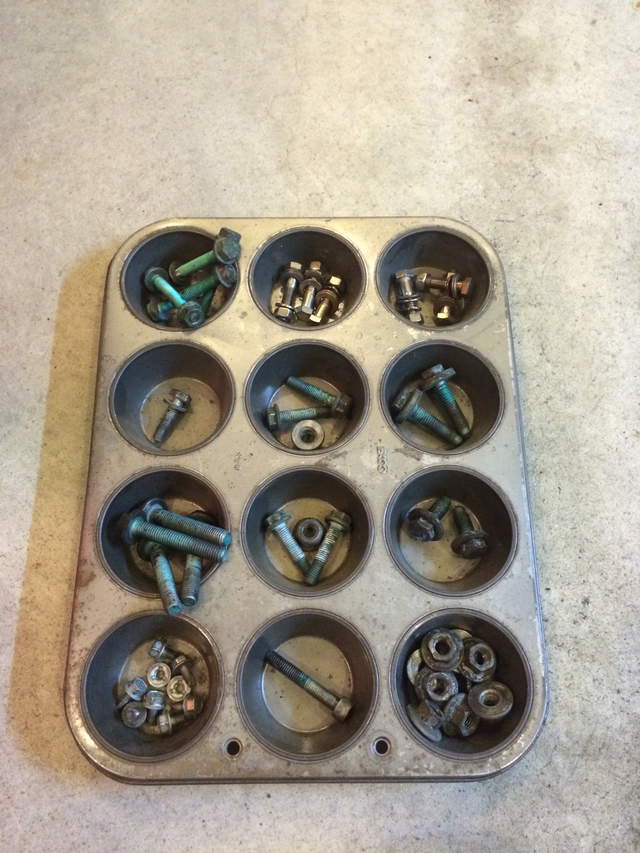

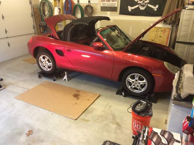

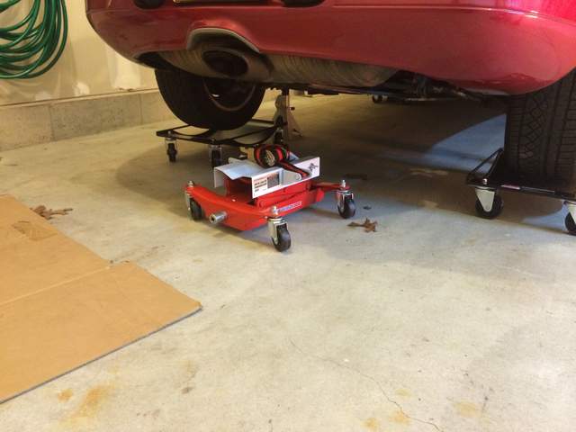

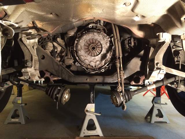

I'm loving the Home Depot bucket giving me more confidence as I get started, lol.
This little transmission jack from Harbor Freight was great for this task!
My stopping point for the day.
I see a little oil...hmmmm...
Starting to make a mess in my garage.
Everything went well so far. I managed to leave the rear bumper on and the axles attached to the wheel bearings. I would have took more pictures but it was tough not getting grease and dirt everywhere. I'll try to take more when I get down to removing the pressure plate and flywheel. Thanks again everyone for the tips and advice!
