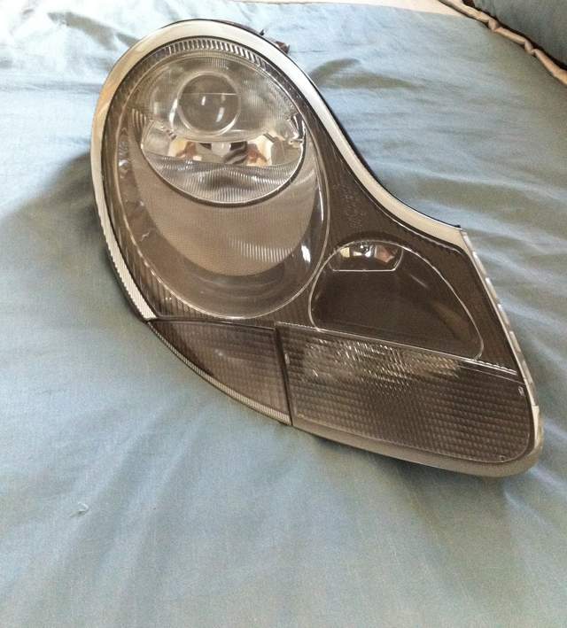

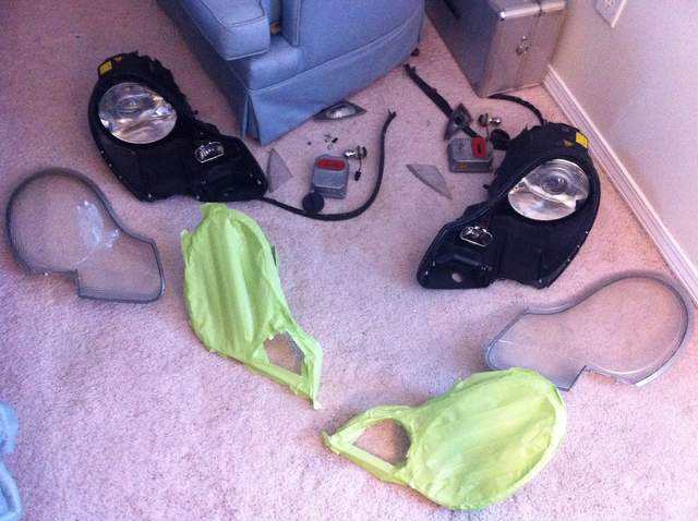

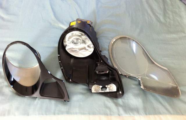

So I decided to paint the inside of my Litronics black for a more modern look.
Before:
Gutting and painting:
After:
I decided to go with the black around the headlight and get rid of the silver to bring it all together. I also deleted the headlight washers for a cleaner look. I haven't used them once in five years.

Looks great. What kind of paint did you use? Did you paint the inside of the bezel, or outside? How did you remove the silver paint from the lens?

Another thing that would be cool is you writing up (step-by-step) how you opened the headlight, but most importantly, how you sealed them back with what material/silicon etc. I did my headlights recently but my Frenchglish prevents me from doing a quality DIY on this.
Another guy did an excellent DIY on opening them but if my memory is good, he forgot to mention details RE how to seal them back together. If you could do a complete DIY on this that would be rock & roll buddy.

I kinda like the colored Porsche crest on the hood. There is already a write up on here wih photos and everything on how to open the headlights. Basically bake them in the oven on 220 degrees for about ten minutes then pry the lens off. I sealed them back using black RTV silicone.

Hi Heliguy, I am also in the process of installing projectors on my Boxster. I have one question regarding the headlight lens. How did you paint the bezel around the headlight lens black. Did you remove the silver paint? If so, what is the best way to do that?

It's not paint...I applied black automotive vinyl wrap to the outside of the lens. It was a long process of cutting and fitting, spraying with soapy water, heating with a hairdryer, and smoothing out the bubbles.
