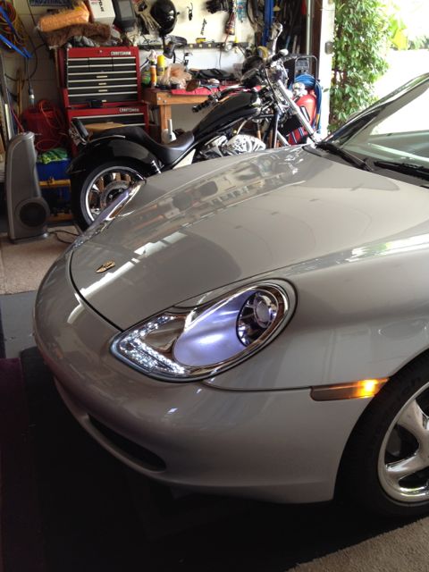

particlewave 09-04-2012 03:44 PM
BMAN, please post more pics! Like, at least a dozen :)
I photoshopped the chrome units onto my Glacier White Box, but didn't like the look. Must have been my photoshop work because I'm really liking your pic :)
Would be nice to see the whole car from different angles.
TIA

geetee 09-05-2012 02:19 PM
I got mine in. HID 8k low beam. regular high beam and HID 6k fog's.
Probably one of the best esthetic mods you can do to the front. Car looks way more modern.
Couple tips. Do not try to put the lights in without putting the back cap on the low beams. The headlights will flex and the top of projector portion rubbed on the inside of the headlight cover....grrr.
I had to flex the tap where it locks in as mine would not seat. I even took the headlight tray out to confirm why it wasn't seating. I used a pair of plier and massaged it a little and all is well.
It looks freakin awesome.
