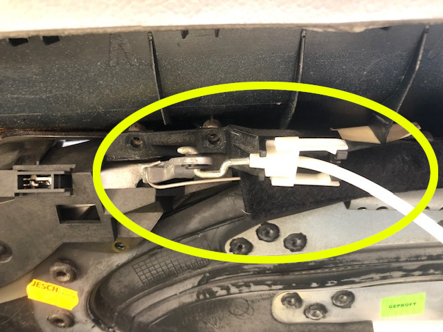

Investigation: I am investigating the problem and had to remove the door panel. However, unlike 101 Boxster Projects or Pelican's tutorials or various Youtube videos, my door handle cable is different and does not come off. The attached image has it circled in yellow. So the panel comes off but is held to the door with the cable as seen in the photo. I am keeping it on a stool while trying to get access to the door handle mechanism but it is quite difficult with the panel in the way.

Spread the white clip apart to release it, then slide it to remove it. Shown in this video set to about 2 minutes 30 seconds into the video:

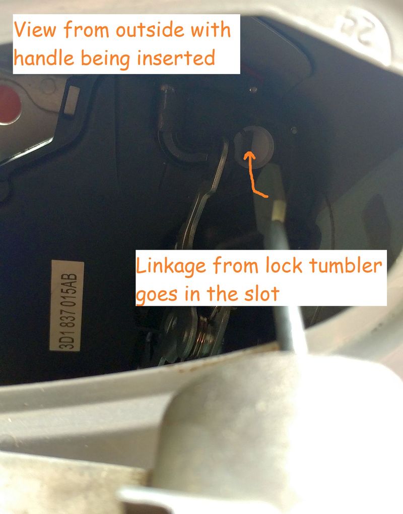

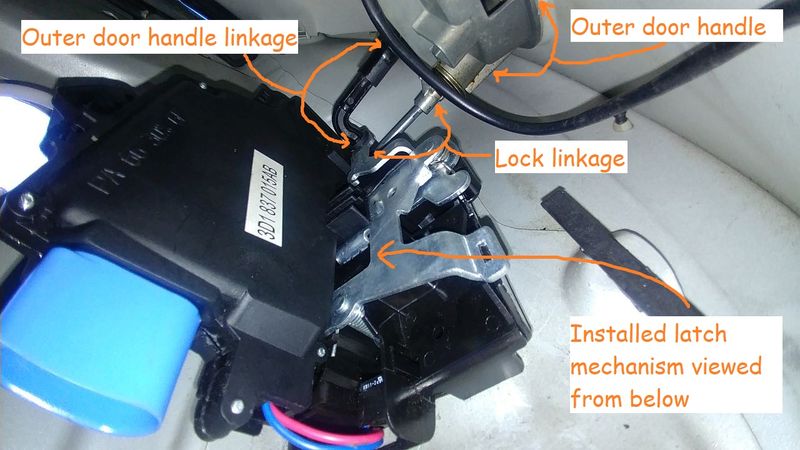

At around the 8:00 mark of that video there's some info that you might want about the outer latch.
Here's the pics from that.

Thank you so much! this tip and video helped me out quickly !
