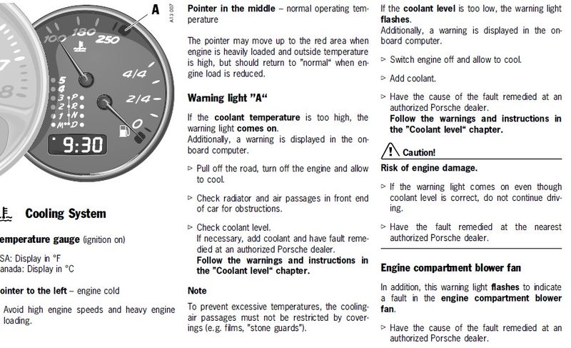

Years ago, I think it was possible to download from Porsche. There's still got to be a few sources online, but I think that Porsche corporate hunts them down and kills them. Here's the coolant indicator warning page. I'll see if I can find a link for the '03 manual still.

Four functions of the coolant warning light:
1. Engine coolant level too low
— light flashes slowly (0.5 Hz)
2. Engine compartment temperature too high
— light flashes slowly (0.5 Hz) (engine compartment blower might be faulty)
3. Engine coolant temperature too high
— light is lit; pointer on the right
4. Temperature sensor at water outlet faulty
— light flashes rapidly (1 Hz); pointer on the right
Note
The temperature warning in point three is indicated if the conditions "engine coolant temperature too high" and "engine coolant level too low" are present simultaneously
(1Hz = 1 flash per second. 0.5Hz = 2 seconds per flash)
