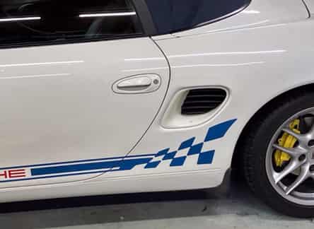

Engine side vent types
The engine side vents on my 2003 Boxster side vents sit on top of the sheet metal, some others that I’ve seen fit nicely inside of the body. I’m guessing this is an “early vs late” vent thing. If this is so, can these be interchanged? I’d like mine to be more recessed. I’m ok with a little judicious body modification to make it work. What do you think?

Likely they can. I swapped out my "deep" vents, which I believe are stock... for the turbo vents, or something along those lines.

The two sides are different because the vents serve different air flow purposes: Driver's side is an air intake for the engine, passenger's side is an engine compartment heat vent

Update. I installed a pair of early vents in the 2003 and they fit perfectly. I’m pleased with the more streamlined look. Thanks for the constructive comments.

BTW, I’m working on adding a single horizontal splitter 911 style. Similar to the pic below. I’ll post a pic when I’m closer to done.
Interesting! Did they drop right in?
Tom Coradeschi
03 Boxster
tcoradeschi is online now   Reply With Quote
Old 03-19-2023, 02:30 PM   #20
Join Date: Jan 2023
Location: KY
Posts: 22
Yes, no problem..
