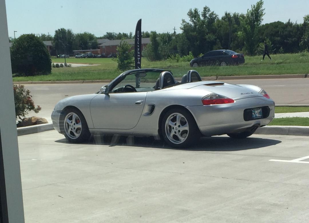

So i went ahead and bought a new 98 silver Boxster. This car was found locally and has half as many miles as my current car. My plan is to swap some of my favorite parts from the current car to the new one. When I'm all done swapping I'll sell the higher mileage one.
I've also sourced a somewhat local car being turned into a race car. That is good because I'm not sure I like the interior color of the new car. So i will most likely do a complete interior swap as well.
One problem with the new one is the top. It was converted to manual and it still has the plastic window. I will be getting a aftermarket glass window top with frame. The frame on the plastic window actually broke at the driver side ball joint point. So seeing I needed a new frame anyway I thought I would get a whole top and frame complete.
Troubleshooting why the PO converted to manual I noticed the ball joint part was broken (this was before I bought the car). So I already assumed something was pretty wrong with the system to break the frame. While pushing the top button I can see only drivers side transmission spins. The passenger side does nothing and seems to jammed. So i will be taking at least that side transmission apart, probably both. I'm hoping it is just a broken gear, but we shall see.
Other problems so far are the ignition switch is a little wonky, easy fix. Rear spoiler is binding up on one side. May remove this completely if I put the Aero kit trunk lid on this car. And so far that's about it.
I will keep this thread going as I transform the car this spring.

Started by changing the headlights.

Hi all, just updating this thread with the progress on the car so far. The weather here has finally warmed up and stopped raining everyday so I've been able to start working on the car more regularly.
So far I have swapped the headlights, tail lights, sun visors, wheels, wheel spacers, e-brake handle, shift knob/boot, Bens short shifter, center console, steering wheel, air bag, all switches with blue LED's, gauge LED's, HVAC controller w/blue LED, clear side markers and all trunk seals.
Added US spec lighters one always on and one with switched power for radar detector. Added black heated seats and black floor mats. Added new (used) glass window soft top and new wipers.
I disabled the rear spoiler because it doesn't work correctly. I was considering swapping the whole aero kit from the old car, then the spoiler wouldn't matter because of the fixed wing and longer trunk lid. I've decided against that now. It seems like the factory fitted aero kits actually drill holes to hold a rail below the doors that hold the side skirt. I don't want to have to deal filling the holes, so the old car will keep the aero kit and at some point I will fix the spoiler.
I took off the front bumper cover and cleaned out the radiators. Lots of junk in there but no dead birds thank god. While it was off I washed of the air intakes and used some back to black to make them look like new. I also added mesh using plastic gutter guard. I put it on the outside of the grills, i think it looks better like that. I got a Roll of it at Lowes, it was on clearance for $0.33.
Things I still need to do are: Pads, rotors, paint calipers, swap mufflers, install carpet, door cards and dashboard. I also want to make the top automatic again. Once I'm confident it is working correctly I will put the one touch relay in. I need to make the heated seats work.
I have a 996 throttle body I may swap, not sure yet. At some point I will change the water pump and put in a low temp T-stat. That's about all for now.

Yesterday I swapped out the stock base muffler for my internally modified S model one. Now it sounds like a proper sports car.
Today I took it easy. The only thing of note I did was put the spoiler on correctly since it seems I missed getting a couple of the tabs to go under the lip on the metal part, installed my carbon fiber license plate frame and made my top into semi-auto. I hooked up the clamshell to the transmission so it now sits flush with the trunk lid. It was driving my crazy that it didn't sit flush with the top up. It was even worse with the top down. Now it sits flush top up or down.
Next steps are make the top fully automatic and do the new pads, rotors, paint calipers and apply silver stickers. I have taken a bunch of pics during the transformation and will be posting them soon.
