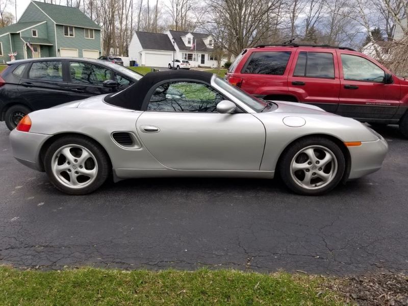

tommy583 04-07-2022 10:32 AM
http://986forum.com/forums/uploads02/side1649352751.jpg

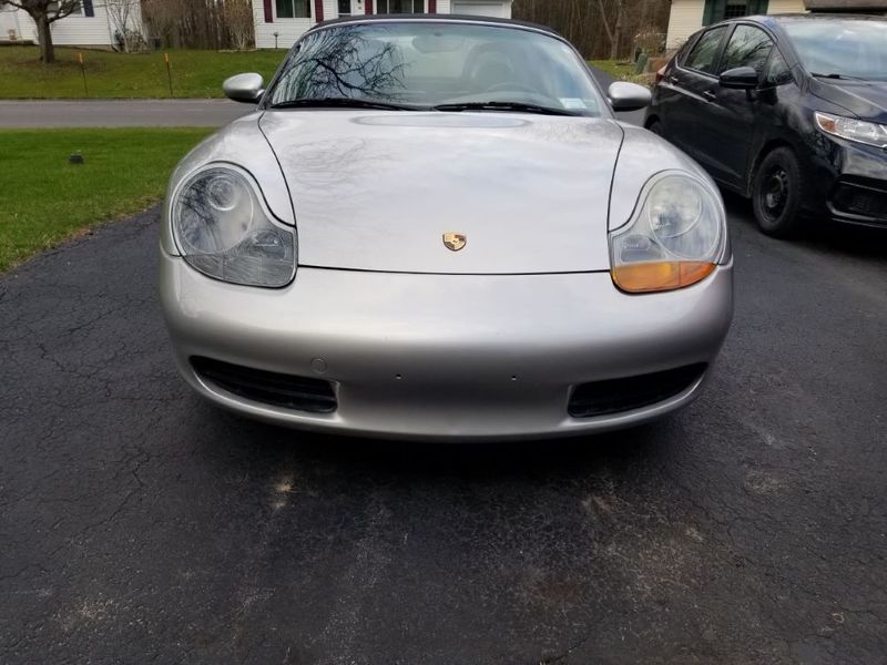

tommy583 04-07-2022 10:33 AM
http://986forum.com/forums/uploads02...1649352783.jpg
Started by changing the headlights.
Outkasted 04-07-2022 12:35 PM
Easy place to start. Will enjoy watching the transformation.

two different headlights?

tommy583 04-08-2022 04:16 AM
Haha it's a good look no?
