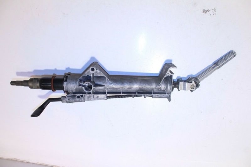

Here's the steering column:

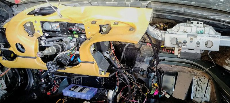

I don't have a good pic handy of the dashboard fully removed, but this one shows some of the framework under the dash cover:
It's going to probably require some fabrication of the framework to raise the steering column. Have you looked at doing a console delete? It opens room for your right knee.
