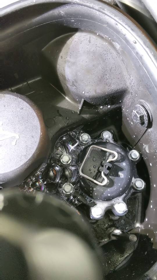

It could also be the bleeder valve.Name:  PXL_20201201_041337940_exported_11428_1613345897890.jpg
Sent from my Pixel 3 using Tapatalk
