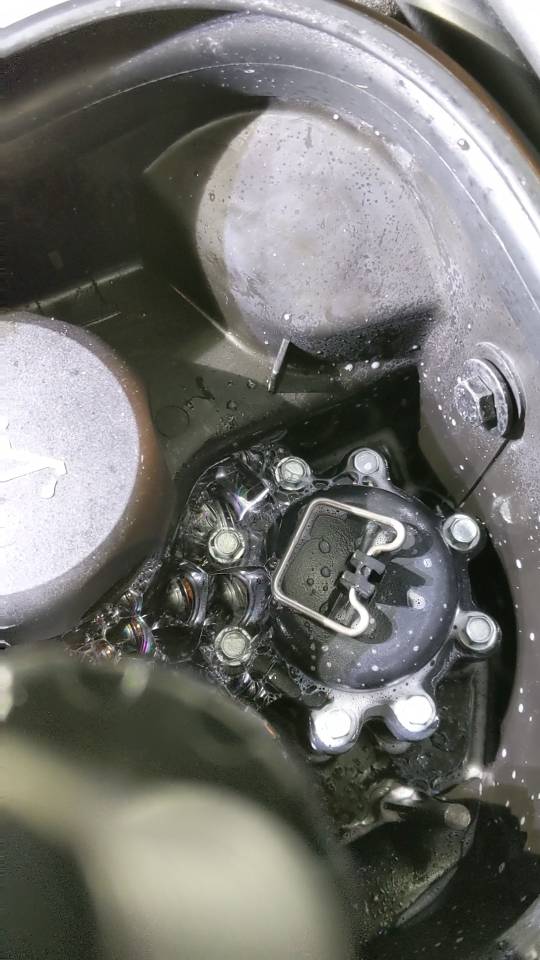

http://986forum.com/forums/uploads02...1621106698.jpg
This is the tube here. The liquid coming out is a light green and is like water so i would think it's coolant.
BYprodriver 05-15-2021 11:38 AM
I bet your coolant tank cracked, See if your trunk is wet.

paulofto 05-15-2021 12:12 PM
Check your coolant cap. Make sure it is the latest version ending in 04. Older ones are known to fail at the relief spring and erase coolant well below the proper pressure.
RobT987 05-15-2021 12:22 PM
It could also be the bleeder valve.Attachment 22952
Sent from my Pixel 3 using Tapatalk

blue62 05-15-2021 12:57 PM
The hose in your picture is the coolant overflow hose.
So with the engine overheating the hose is doing what it is supposed to do.
Venting expanding coolant.
The best way to diagnose coolant systems issues is with a coolant system pressure tester.
Harbor Freight has them for reasonable price.
Sounds like either your coolant overflow tank, the bleeder valve or the coolant cap is toast.
