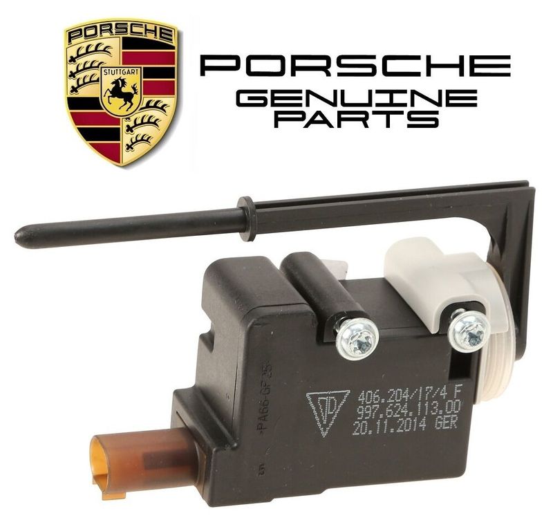

You're not talking about the Fuel Door Lock, are you? "Rod Shaped" and in that vicinity made me think about this.....

I have been there, it is a sensor, if you look close it should be captured by the assembly that held the evap valve, it should be held laying on the fill tube.
I was think that as well

It's probably the OSVR reed contact which sits inside the bleeder valve just under your fuel filler. The bleeder valve has an orange circular face on it. There's a good article in pelican parts that shows you where it goes but there is an obvious recess inside the valve. Without it fitted, you may have a problem filling up. This is an issue that I've had for a while as my car doesn't have one nor can I find the wiring for it!!!
