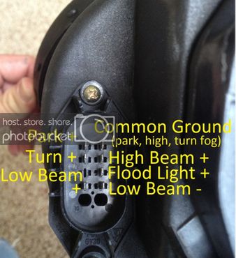

Test each headlight for continuity between the low beam positive and negative pins (with headlight out of car, bulb in and after verifying there are no shorts/missing insulation on wiring inside headlight).
Check the cars headlight socket side connector for power (with key and headlight switch on).
