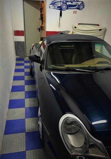

Interesting, the sellers pics look good.. How about a pic of yours? Downsides?
Old 06-27-2019, 12:20 PM   #5
Cunningr's Avatar
Join Date: Mar 2016
Location: Spain
Posts: 996
I can try for a pic this week end. I did a blue and silver checker pattern. Only down side so far is i accidentally let my foot slip off the clutch the quick jump caused the floor to slip a little since its not anchored. It has some water channels under it also. I installed the whole thing in 3 hours or less.

Well here is a pic of my floor it is removable.
Attachment 21973
Nice 👌👌👌👌👌👌
