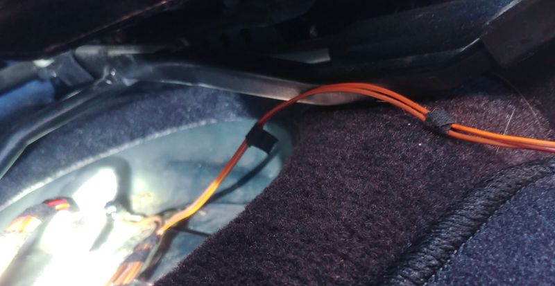

While cleaning it out earlier I noticed something that had never caught my eye. Under the passengers seat there is a wire that looks like it is connected to a ground bolt and splits off to another cable on one end but is not plugged into anything. I tried to find what it is supposed to plug into but couldn't. I've included a few pictures of the wire I am talking about.could this have anything to do with it?

So while cleaning my car I noticed that under the passengers seat is a wire that is connected to what looks like a ground bolt and splits off to a large connection on one end but the other end has a connection not connected to anything. Any chance this could be tied to the problem? I tried finding what it plugs into but it was to dark

I believe you will find that your unconnected wire under the passenger seat is for the optional child seat installation bar's "seatbelt" buckle, which deactivates the passenger airbag when the child seat is installed (but only if your car's computer is programmed for this).
Doubt it relates to your current problem. Sorry.
