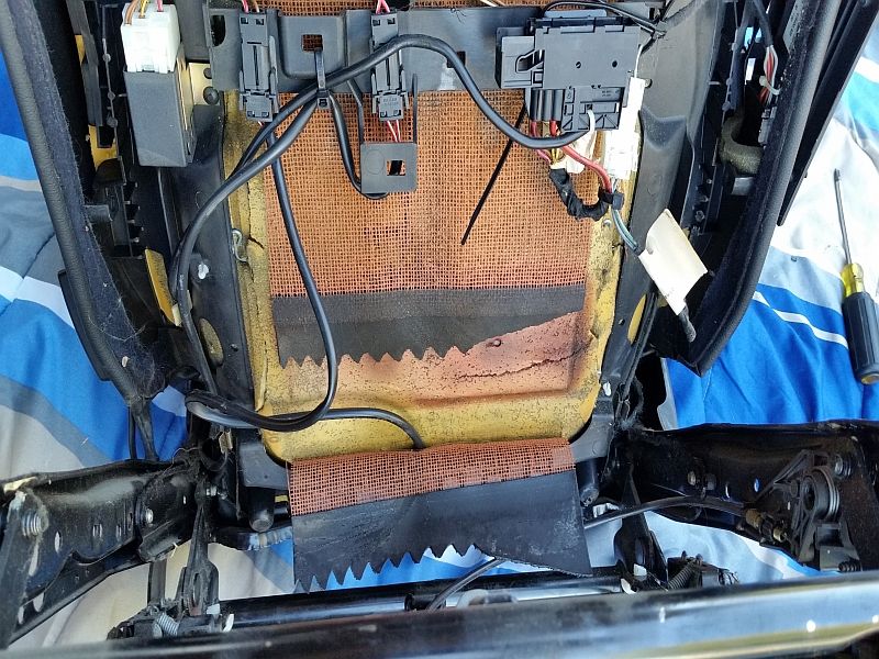

So today i went out in the 04 Boxster and heard (and felt) a pop under the seat. I then felt and heard a second pop. I noticed when I got ihad t to f the car that the seat bottom cushion did not return to text normal position. It was sagging.
I took the seat out and it doesn’t look like the diagrams I have seen online. It has a kind of “band” from front to back with a rubber piece that I assume carries the weight of the cushion. That has snapped. Has anyone wv r had to repair this?

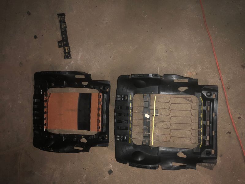

1997-2000 have a much more durable metal spring setup. 2001-04 have a plastic mesh spring. The 01-04 mesh or the plastic frame will eventually break. It's easy to retrofit the earlier frame and springs into your 04 seat cushion

A couple years ago I repaired one and started making a DIY ...and never posted. Here's the pics I still have:

My pictures may be hard to completely follow along without a description. I did not attempt to repair the band; I completely replaced it.
1. remove the old band completely.
2. Cut a heavy material to replace the band. I used a scrap of trunk liner (grab one for a couple $ at a junk yard if you don't have a suitable material) cut to about 11 x 13 inches.
3. Insert heavy duty zip-ties in all of the attachment points (around the metal rod).
4. Line up the material with the seat frame, mark then drill holes for the zip ties to secure it.
5. Put the material in place, insert zip-ties and tighten.
***note: I did add two additional holes for zip ties on the left and right side of the plastic frame.
Mine has held up well for 2 years and is a little more firm than the original.
I could send you a seat base from a '99 if Woody doesn't have one available. Good, but looks like partial cracking in the leather along the stitching in one part.

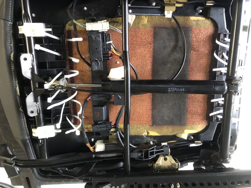

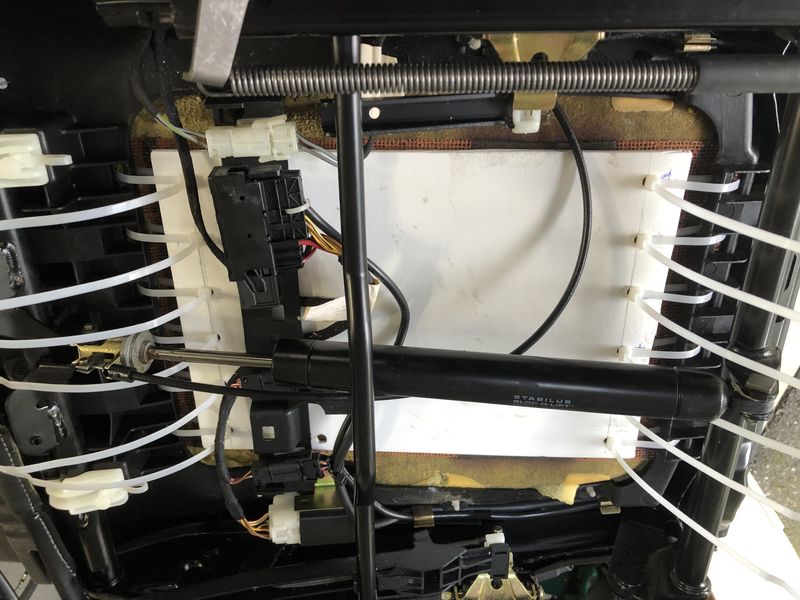

Did my driver seat today
Now that track season is over until next spring, it's time for me to remove my track seats and put my standard seats back in. The band on the bottom of my driver's seat hasn't broke, but the cushion is definitely a little saggy. I didn't have access to any trunk liner material, but my wife is a real estate agent and she recently got new signs, leaving me the old signs for various projects. They are some kind of heavy duty PVC plastic sheet, about 3/16" thick. So I cut a piece about 12"x8.5" and attached it with zip ties. The hardest part was threading the zip ties around the steel rod. I used a flat blade screwdriver to easily pierce the webbing on both sides of the band material, inserted the zip tie and then stuck a needle nose plier into the foam and under the steel bar to grab the end of the zip tie and pull it through. Once I was satisfied that the zip ties were tight enough, by sitting on the seat on the garage floor, I cut off the excess ends of them. Some time this week I will install the seats in the car and take a test drive. If I'm not happy with the results then I'll do something else when the seats come out next spring and the race seats go back in.

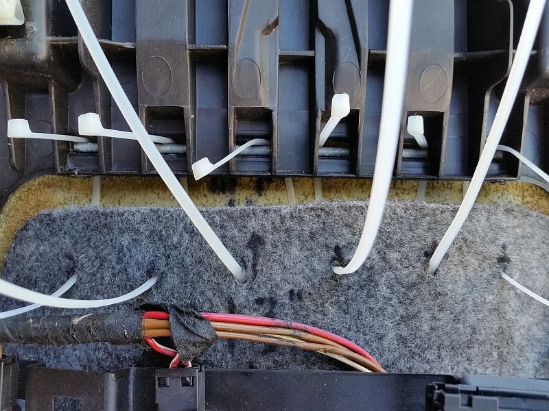

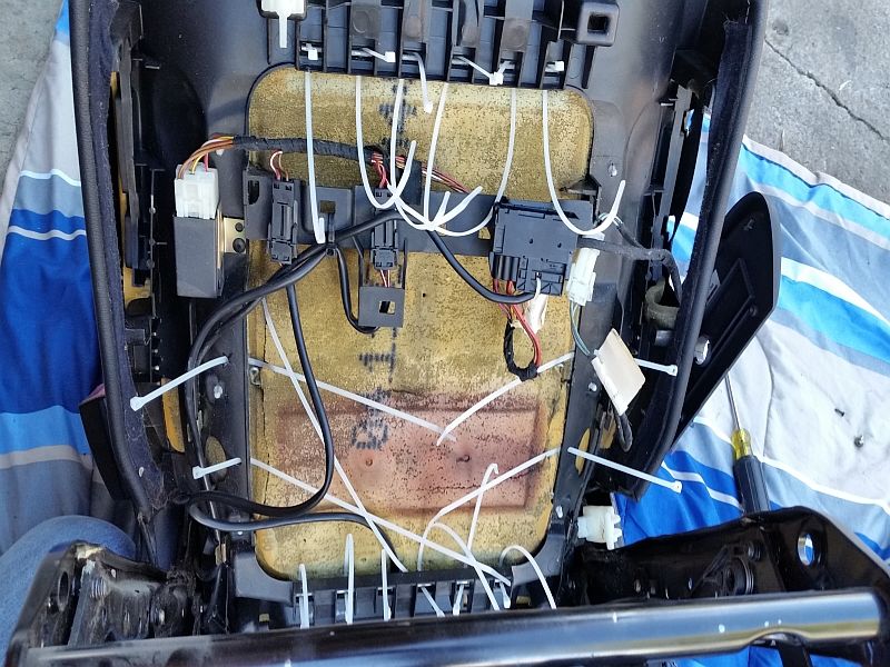

Torn seat bottom mesh zip tie fix
I ran into the same issue as others have, that sinking feeling and the feel of ripped material under the bottom of the seat. I decided that since the time is also coming where I’ll need new leather covers, but not now, to perform a support and zip tie operation. I cut an plastic lawn sign it to fit under the seat foam and secured it as others have with zip ties. I added a few side support points. Feeling certain that both my 200 lbs weight and my driving style would cause those zip ties to pull through the plastic sign, I decided to weave zip ties across the bottom of the plastic support piece in a zip tie webbing fashion. It should hold up for a while. Also, no need to disconnect the battery to avoid an air bag warning light. Just take the key out of the ignition before you disconnect the wiring harness under the seat. That can be easily accomplished by using a 6” piece of 2x4 lumber to prop up the seat (after unbolting) twisting the connector counter-clockwise 45 degrees to detach from the frame and on the passenger side of the connector, pulling a clip on the connector in the direction of the passenger side of the car thus freeing the plug which then easily pulls out.
