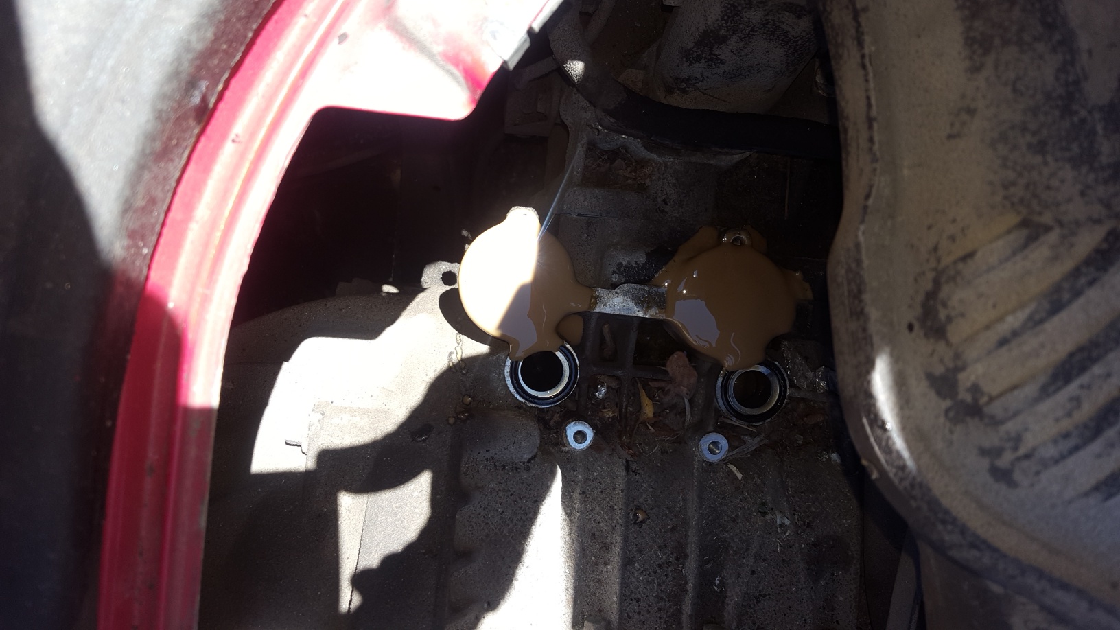

Posts: 41
Thoughts? pic of the oil cooler removed.
Oil cooler or head?
It appears that sludge is only on the coolant side in the pic.
