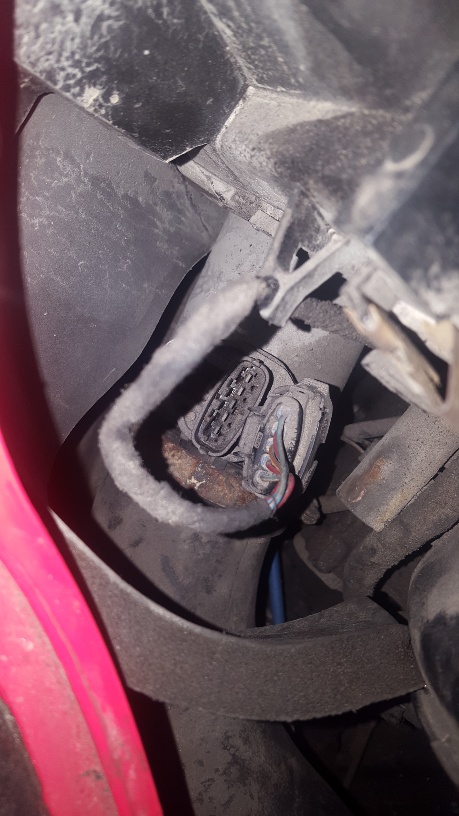

AOS and oil cooler replaced.
Now the flushing starts.
When I started the process I noticed that the plug for the air intake was unhooked.
When I finished and started the car, it wouldn't idle unless I unhooked it.
Any ideas?
Any ideas?
Attachment 21569
Uh, that plug is your MAF sensor... not sure how the car is running without throwing codes with it disconnected. Have you ever had a look with a code reader? Something is not right with your overall system. Could be as simple as needing a new MAF, could be a can of worms... probably has nothing to do with your oil issue though... also, please clean that engine while you are there... makes it happy.

Weird...I'll have to dig out the reader.
CEL has never come on.
Car runs fine with it unplugged but stalls if I plug it in.
And yes a complete engine detail is in order.
Want it working correctly first.

Start by purchasing a can of MAF cleaner, give it a good cleaning and see if that helps. Cheap solution if it works. Just make sure you don't physically touch any of the sensing elements.
Good luck!
