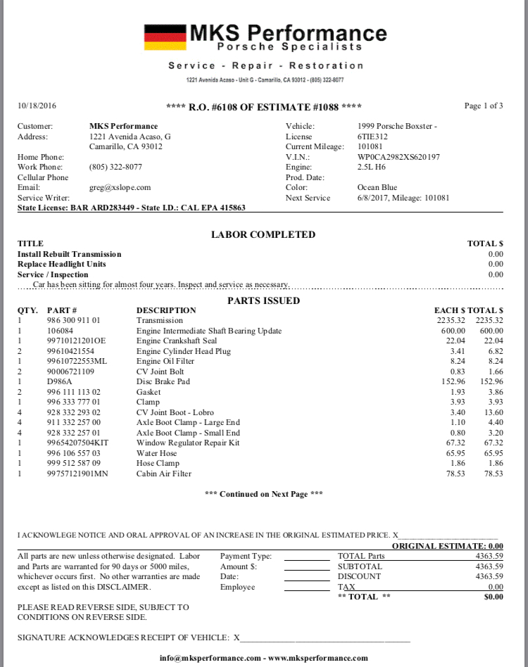

I'm trying to find the IMS/RMS on this invoice on a 2002 Boxster S. I was told by the seller that it was done at the same time as the clutch. Well, the invoice for the clutch is attached but I don't see the IMS/RMS as a line item. Can you help me out?

997-101-212-01 looks to be the RMS.
996-105-024-01 comes up as the IMS flange. From the looks of the part on the Pelican website, it appears to be a flange associated with a single-row bearing.
I don't see anything that indicates that they replaced the IMS bearing though...

Thank you! Maybe they inspected the IMS and it looked good?

It’s not done. Probably wasn’t necessary. They don’t all break. When I had mine done at around 60k miles, my mechanic said that the old one was in great shape. Maybe I blew a couple of grand for nothing? Toss the dice.

No, they just resealed it.

RMS yes.
IMSB no.
