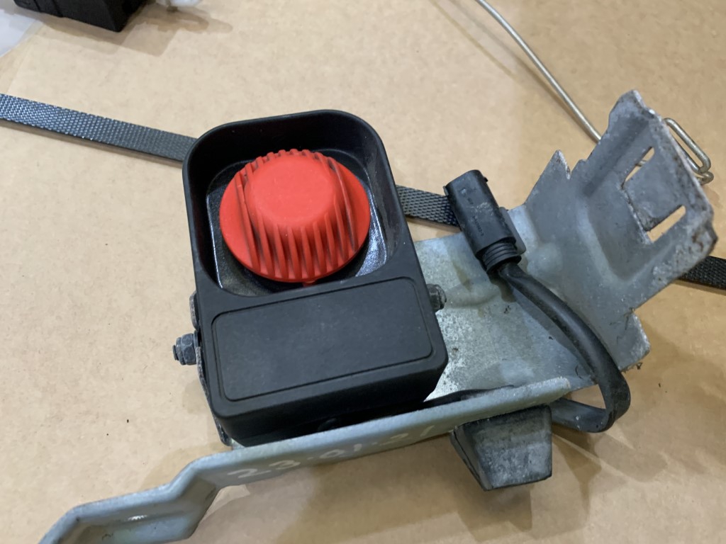

I also like to disable the Siren on my 986 2.5. I have located the siren but just wondering if there are any procedures for removing it? If I just disconnect it will the siren go off will the battery die?
