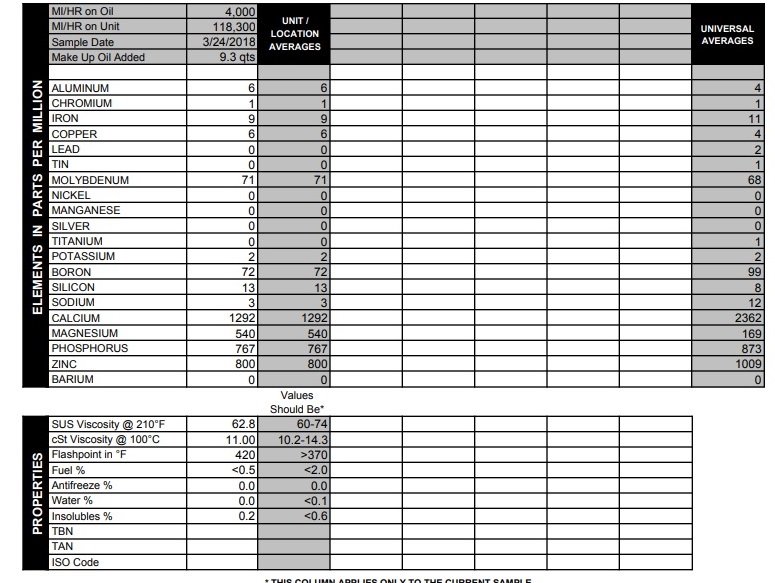

Just received my oil report
Never, ever had one done on any vehicle ever I've owned. Thus, I'm ignorant on how to "really" read one.
Numbers look OK in some cases... but causing (unnecessarily) some grief because a few numbers look "out there".
1998 Boxster
Oil Type Grade 0/40.
Oil Use Interval 4,000 miles
Their comment:
Universal averages give you an idea of how these engines normally look with about 4,300 miles on the oil. This run was close to that interval and wear metals are all close to average. That's how a healthy engine looks in testing, and this 98 Boxster seems to be getting along well at 118,300 miles. We're guessing (hoping) 9.3 quarts is the sump size, not top-off oil needed between changes. That would be an alarming amount of oil use, and more than enough to dilute spectral results. The oil is in good condition, with a normal viscosity and no harmful contamination.
Is their comment unusual?
I welcome our seasoned pros give the attached a once over and share with me your wisdom.
Thank you.

Did you really add 9.3 quarts of oil between oil changes? They seem to be commenting on that, which I would guess you put on the form (I hope erroneously) next to the question they ask about how much, if any oil you used to top off between oil changes.
I drained all the oil from the bottom, and replaced the oil filter. I refilled with ~9.3 quarts.
Admittedly, I was a little confused when filling out the form. From the time of the last oil change I added zero oil. So, now their comment makes sense.
Thank you for clearing that up for me.

You have a baseline now to compare future reports with. If something starts to deteriorate, it should show up here.

EXACTLY as the previous poster said........an oil analysis is only useful if done each time the oil is changed. It's "value" is as a "trend report". As previously said, now you have a base-line from which future reports can be judged against.
Personally, I don't see much of a benefit in an oil analysis. I know large fleet companies (trucks) typically do them as a way to track their fleets. When I owned an airplane I used to do them, but after I had a cylinder failure with NO indications or even hints from my previous years of oil analysis I stopped.

I might consider an analysis every 3 oil changes, keeping an eye out for anomalies. Thank you for the advice. I did cut apart the filter... stretched it out... looked for metal, saw none... ran a magnet, nothing. For the most part, the filter had zero debris causing me concern.
If you recognize any aberrations in any of the numbers, please advise.

Magnesium a little high?
What is made of Magnesium in this engine?
From another poster in another forum, in part:
However, if the the IMS bearing were going bad the amount of say chromium or manganese would be up too since the IMS bearing's composition is probably SAE 52100 bearing steel which contains carbon, chrome, iron, manganese, phosphorus, silicon, and sulphur...
Also, I read that certain oils have more additives than others... and I fail to recall exactly what I put in the oil change before last.

I've been doing some reading about the oil analysis, and reviewed more than several reports.
It appears some oils have more magnesium as an additive while others employ calcium. On the reports I looked at if the magnesium count was high, the calcium count was low... and vice versa. I'm going to believe it's the oil brand, and believe my preliminary sample to be Mobil 1 if I remember correctly.
Clearly, having the test done on a regular basis will reveal trends, and I'll then start considering alternative oil choices.
