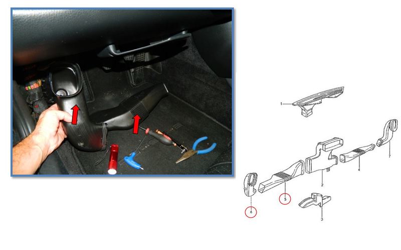

this thing is a pain the the butt.
i took it out a dozen times and still i can remember how it goes in. always takes me few minutes of fiddling to get it in.
this pic should give you a good start.
