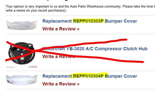

I have bought two bumper covers from APW using a discount for free shipping and 15% on one, 20% off an the other. (They send discount emails weekly.)
I can never find the part using their normal catalog, but here's the one for a base model: http://www.********************************************************************************************/sku/Replacement/Bumper_Cover/REPP010304P.html?loc=Front
I got that to my door for under $300 (primed).
It looks like their S model bumper I purchased is no longer available. Part number was: REPP010303P and it cost about the same.
