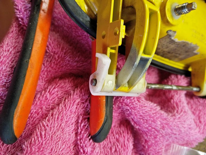

I have now got the replacement spring and dismantled the door handle but with a problem.
The rod holding the spring mechanism is stuck solid, I guess with corrosion and I can't slide it out. I guess there was nothing much wrong with the original spring.
You can see the metal rod in the photos.
Apart from soaking it with WD40 and very lightly tapping the end does anyone have any further suggestions? I can't rotate it with grips and as it is just about all made from plastic I can't see heat is an option.
I will leave it overnight and see if the WD40 penetrates but I'm not holding out much hope as there is no free movement at all.

The soak worked but I think the best thing I did was use the sharpest thinnest blade to work the gaps in the parts butted together to allow the oil in.
Gripped the rod in the middle as tight as I could with locking pliers and was able to rotate the rod eventually.
Clamped them to the end and was able to rotate and pull at the same time. Tapping the end with a hammer was never going to work and would eventually break something.
All greased up with new spring and ready to install.
