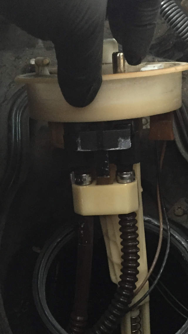

Here is the pic of the fuel lines. They are supposed to come off easily but i can't figure it out. How do I get these off?

Old 11-10-2015, 04:29 AM   #56
I am my own mechanic....
Timco's Avatar
Location: Salt Lake City, UT
Posts: 3,432
Those connect to the fuel pump, don't they? They likely unclip from the FP.
'08 VW Touareg T-3 wife's car
Old 11-10-2015, 06:28 PM   #57
jeeper31's Avatar
Location: Long Island
Posts: 180
They come off the fuel level sender. I just don't know how
jeeper31 is offline   Reply With Quote

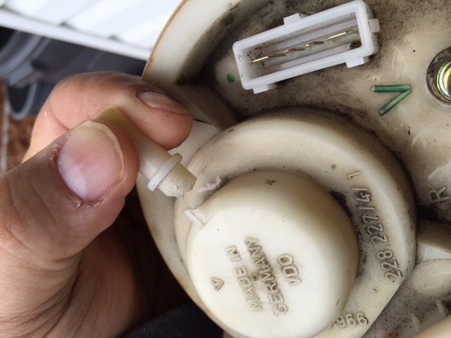

Ok got fuel lines off.
Here is the part I broke. Wondering if I can glue it and if so what glue would be permanent?

Old 11-11-2015, 02:53 PM   #59
Join Date: May 2014
Location: S.California
Posts: 2,029
A hack would be to use a coarse threaded brass nipple +epoxy.But if it failed after a few miles....
A good used pump may be wiser?
Old 11-11-2015, 03:15 PM   #60
jeeper31's Avatar
Posts: 180
That's the fuel level sender. Buying a new Porsche pump but trying to save the $280 for the sender.
