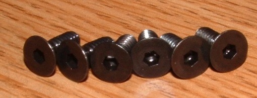

So I hit a wall in getting to the engine compartment. I reached the point where you need unscrew the 5 screws to remove the cover, and didn't really have any problems getting to that point. Followed the instructions in the manual and got to the engine cover rather easily, without issue.
The problem is the 5 screws. They won't budge! They are really tight. They seem to be some kind of "allen" type and the only thing I found that fit it fine was an old allen key that was used on some furniture I put together. It's a little, flimsy key and I just couldn't get any of the screws to budge.
The back cover made accessing the panel somewhat difficult, it's really not completely open and accessible; so I was half bending over the car in trying to unscrew, and I just couldn't apply enough strength.
Only thing I can think of is using some WD40 and see if that helps. Judging by how tight & snug these screws are, I don't believe this thing has been opened in a long time; and if it hasn't - my guess is I'm running really low, if not empty, on the power steering fluid. So before I take this car in, I'd really like to get those 5 screws open somehow and check the fluid level.

I did a quick google search on Zeuse clips, and what I'm facing is totally not Zeuse clips. I don't know if they changed with 987's, because I do see a lot of Internet images of 986 and older Boxster's using Zeuse Clips for the engine cover, or if the previous owner of my Boxster replaced the Zeuse clips. But what I've got are actual screws - they are going to need to be unscrewed completely. They are really screwed in and bolted down hard.
Unfortunately I closed everything up so I can't take a picture this second, but this is the closest that I could up with on Google, except they are Gold plated and have even more inner rings/grooves then these:
Incidentally, Page 186 of the owner's manual also speaks of using an "Alen Key" to "unscrew" the 5 "catches". So I'm almost wondering if they changed the Zeuse clips to these really funky screws in 987. I could be wrong.
Either way, these are definitely screws and they are ridiculously bolted down hard.

Ahh, I didn't realise the 987 may have a different lock down system.
You will need to buy a cheap set of Allan keys from your local auto store - they are very cheap but without them you will not get them to unscrew.

So as it turns out, I did have the right allen key in my tool box. I have a set of about 18 allen keys & screw tips for one of my power screw drivers and one of them fit like a glove. It's the 5/32 key. As planned - I had sprayed some WD40 on the 5 screws and let it sit for about 20 minutes. Snapped the allen key on my power screw driver and the screws unscrewed with very little effort.
I have to say, WD40 has saved my life on more occasions then I care to remember.
