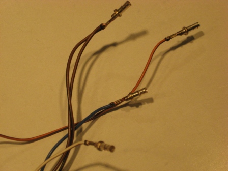

Here's a picture of the pins that were in the connector. They don't have locking pins that could be compressed with the tool I bought.
Name:  IMG_5038 - Com.jpg
