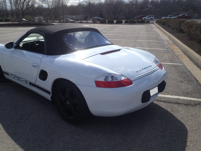

Is that my car in your avatar?
Just kidding...kind of
Good taste
