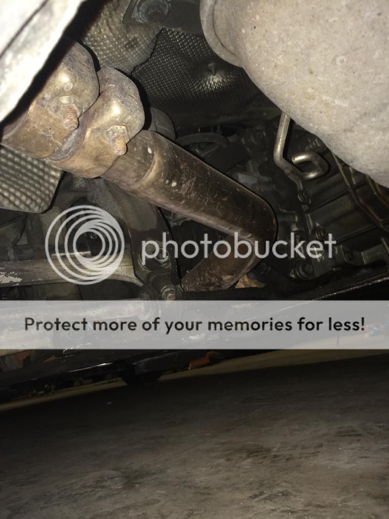

I have the Fabspeed. Beware. No coupling and to use your current muffler coupling I had to weld on about 2" to each side. Then, each side came with 2 bungs for O2 sensors, and the rear pipes have none. So copper washer and found bolts in 'sensor' thread to plug them.
Note. I welded onto the elbows, not the pipes. Very nice pipes, great fit and shape and finish. Nice and fat. Great sound.

Yes - actually it was your post that made me weary about the Fabspeed pipes, I think the holes you had to plug by machining down those huge bolts is to accommodate the ROW Euro setup that had CO2 sensors in the secondary cats (totally not sure if that's accurate, but I think it is).
Anyhow - the pictures they show on their page don't seem to have the ports you had to plug:
Was hoping there was a third option though...

And, that pic shows a slip coupling / extender. Mine did not come with that. No big deal if you have a shop with a full welding setup just sitting there a few feet from you, but many would need those extenders.

That's odd about the Fabspeed pipes? I installed a pair on my car and other than some wiggling around, they fit just fine...no welds or extensions. This was years ago, so could the design have changed? I utilized the existing hardware and they bolted right on.
Love the sound with my custom (modded) factory muffler.
I wonder if you got the wrong ones- like wrong year or engine size or whatever...

You tell them year and style and such. Seems I was told they are no different in design but there it is.
