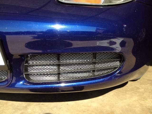

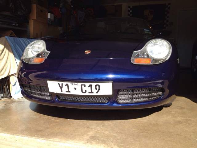

I bought these:
Porsche Boxster Front Bumper Mesh Grill Kit 986 | eBay
But really, you can make them yourself with some gutter guard. I think they look great though and really cuts down on the debris!

I used some stainless screws/washers and black zip ties.
