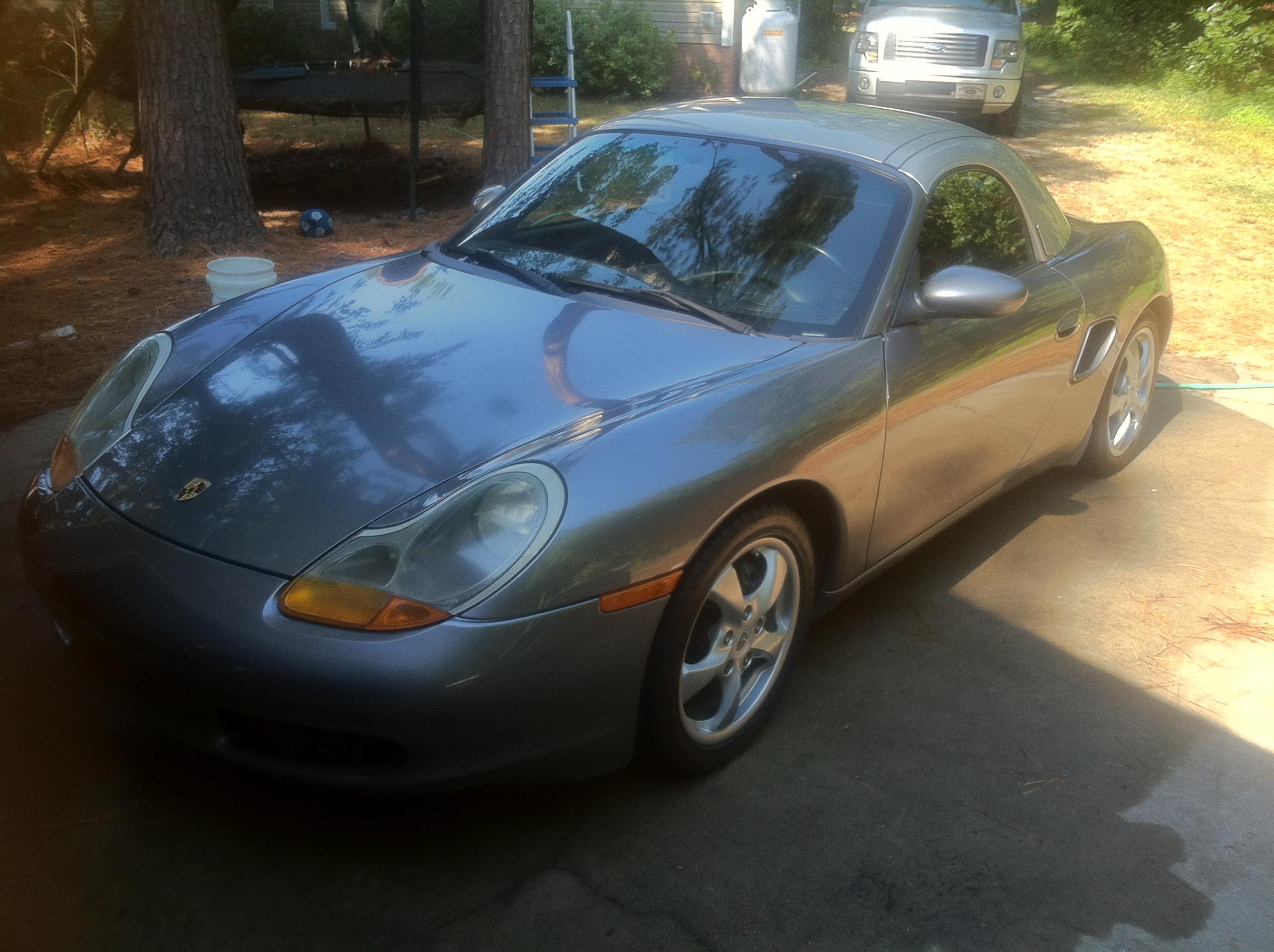

Old 10-26-2013, 06:38 PM   #15
993innc's Avatar
Join Date: Jun 2013
Location: At the Beach in NC
Posts: 102
So here's the car, finally running. Spent quite a bit with the Indy getting the motor put in, new bearing, water pump, under drive pulley and clutch. But it's finally done and with a couple more items I can get to the track while the motor is under warranty.
Got a steal of a deal on the motor and so far it's turned out to be in good shape. Huge miles on it and with the original bearing! Pulls strong so far with race fuel, can't wait to really open it up on track!
