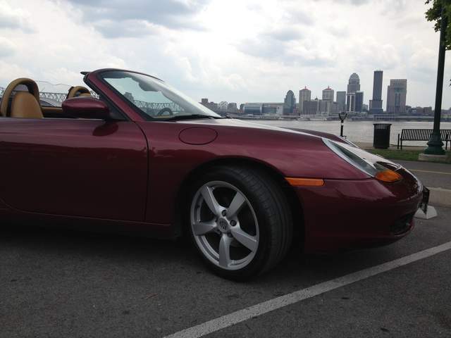

Baby got some new shoes!
I finally found the set of wheels that I’ve been wanting for my 986! I’ve been looking for a set of these Cayman S wheels for quite some time and it was quite a chore to find them in my price range (ended up paying $850 shipped to my door). They came with a nice set of Michelin Sport Pilots (at least ¾ tread still on). I wanted something that looks stock but gave the car a more aggressive stance. This is also the first pics I’ve posted of my Boxster. I love the wheels!..........What do you guys think?
Just for fun.......Does anyone recognize that skyline???

looks real cool.
Jersey City?

wow very nice

Looks really nice, grats!
No idea about the skyline.......

One of the nicer Wheels for the car me thinks!
Are they 18 inch?

Yes, they are 18" wheels. They are OEM Cayman S wheels. The best part is that they don't even need spacers and with the wider tires and slightly more aggressive offset in the rear it gives the car a more aggressive stance that I was looking for.

So your saying that's a wider wheel than a 18 inch Boxster wheel
and takes a slightly wider tire? Nice....

Nice ! Car looks a bit more aggressive looking..you said no spacers..What are the offset on those Cayman S wheels front and back? and tire sizes please? I must assume that there were no issues on clearance and tire rubbing..

Looks good, its nice how modern P wheels look good on 986's
Now get rid of all that amber!

There are absolutely zero issues with clearance/rubbing. I have done some spirited driving just to be sure no rubbing would occur under hard cornering .
To answer the tech questions, I was replacing stock 17" wheels....
Fronts: 7" wide with an offset of 55
Rears: 8.5 wide with an offset of 50
The Cayman S 18" wheels....
Fronts: 8" wide with an offset of 57 Tires: 235/40 18
Rears: 9" wide with an offset of 43 Tires: 265/40 18 (not the correct tire height for the Boxster but it fills it out nice)
What the changes in width and offset equates to....
Front: 15mm farther in toward strut and 11mm farther out toward outside fender edge.
Rear: 1mm more clearance toward strut and 13mm farther out toward outside fender edge.
Keep in mind the the offset is what truly gives the aggressive stance and the less offset, the more the wheel sticks out toward the fender edge. The increase in tire width is minimal but also adds to the more aggressive stance. Due to the fact that my 98 Box has the less powerful 2.5 engine I didn't want to increase tire width and height to the point of adversely affecting performance. The Cayman S wheels have a nice balance of both (IMHO) hence the reason I was so dead set on this wheel (plus I like the style).
