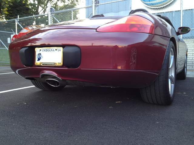

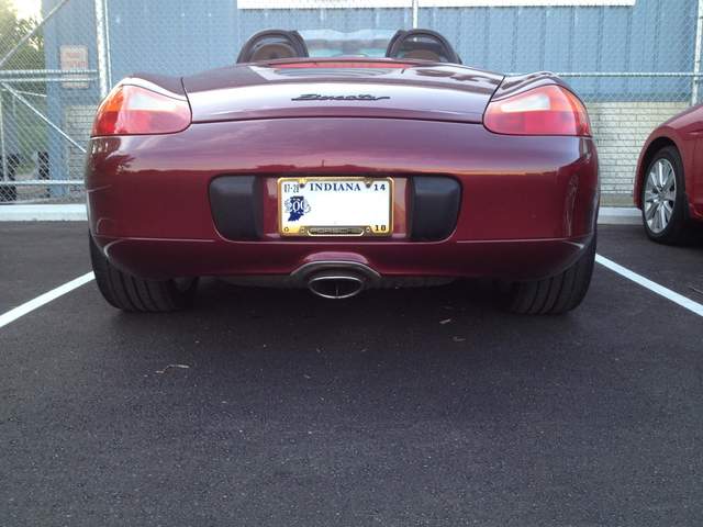

The handling actually feels like it is a slight improvement. It feels a little more grounded in the front (less likely to break loose in a hard turn). Honestly, that could all be in my head and could be totally due to the fact that I love the way the wheels make the car look :D! I haven't noticed a negative effect on the acceleration due to the larger wheels and tires. I was concerned with the 2.5 this could be a problem. Here are a few rear pics. I took one from the side so you could see how the lesser offset pushes the wheel closer to the outside fender.........

I think they look just grand but have a question. I thought that the '98 Boxster could not handle the larger wheels and until the suspension was re enforced in '99 it was not a good idea to mount the larger wheels & tires. Did you beef up the suspension in any way or are you still with stock set up? Anyone else want to correct me or agree on this info. as I may be misinformed here.
AKL

My car has stock suspension. I think that problem was fixed on the 98 cars. The 97s were the only ones that have issues with larger wheels. I could be wrong and would like to know if I'm misinformed.
Allen K. Littlefield 07-26-2013 08:01 AM
I think you may be OK as it was the first year of the Boxster that needed support before a larger wheel could be fitted so you are probably in the clear. Wheels do look great.
AKL
My car has stock suspension. I think that problem was fixed on the 98 cars. The 97s were the only ones that have issues with larger wheels. I could be wrong and would like to know if I'm misinformed.[/QUOTE]
