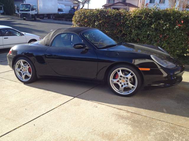

I was able to install the wheels last weekend. The rears are no problem at all. The front tires however rub in the inner fenderwell liner toward the front of the tire at 3/4 to full turn.
The look and stance of the car have changed dramatically compared to the tiny 17s I had on there previously. The car also feels much more planted. I'll try to post pics ASAP.

Before
After

Looks awesome! Now how is the ride, is it very stiff? Are you happy with it?

There are tabs on the fender liners that will allow you to adjust them. Look closely in the area of the bottom front of the fender well, and you should see them.
p.s. I'm surprised that you were able to clear the front struts with a +57 offset. In the event you should decide to install adjustable coil overs, you'll definitely have a problem clearing the perch.
