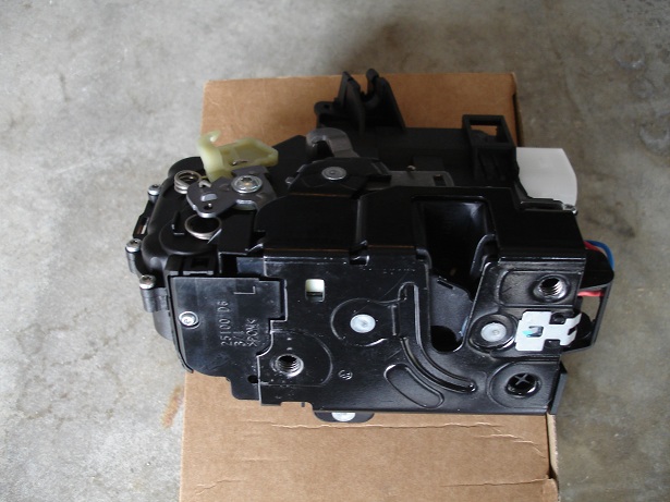

Indications of a failed door locking mechanism, there is a micro switch that fails on these units.

i think you can get just the micro switch insted of the whole assembly.
Pelican Parts - Automotive Parts and Accessories - Porsche & BMW
there is another one located on the external door lever mechanism.
you will be able to diagnose it better with the door cover removed.
you might be able to solve the issue by simply cleaning it with electronic cleaner spry.
edit: links for parts.
Micro switch on door lock mechanism (part 20):
http://www.********************************************.com/porsche-parts/986-97-04/807-10.php
Micro switch on door external lever (part 14):
http://www.********************************************.com/porsche-parts/986-97-04/804-20.php

It does sound as if the micro-switch has failed. Once the car doesn't sense correctly the actual position of the window all sorts of weird symptoms occur. One question: does the window behave in a similar way on the passenger side? The reason for the question is to narrow down which micro-switch failed. Each door has its own set.

don't take me on my word, but it looks like the one on the external lever is the one in fault.
this should help you find your problem.
Pelican Technical Article: Boxster Door Lock Mechanism / Boxster Door Handle - 986 / 987
Pelican Technical Article: Boxster Door Panel Removal / Boxster Mirror Switch Replacement - 986 / 987
