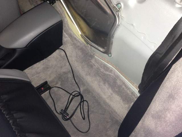

Getting ready to wrap up my IMS-Guardian installation. Before putting the car up on jacks, I thought I'd have the route for the wiring harness mapped out and ready to go.
So... I pulled all the carpeting/padding from around the engine, leaving me here:

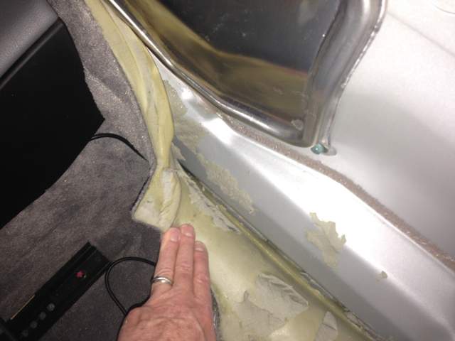

You can see the wiring and the connector for the IMS-G on the floor. But when I began pulling the lower section of carpet away from the bulkhead, I was unable to see any bulkhead plugs...
Just looking for a little reassurance and perhaps a tip... should I keep going in this area? Can anyone point me in the right direction? Closer to the center of the car? Toward the driver's door? Would I be better off on the passenger's side? (It looks the same, by the way, but I haven't gotten down near the floor yet on either side.)
Appreciate any help anyone can offer... thanks.

Did you do that in the area shown in my 2nd photo? (Over the right in that image.)
