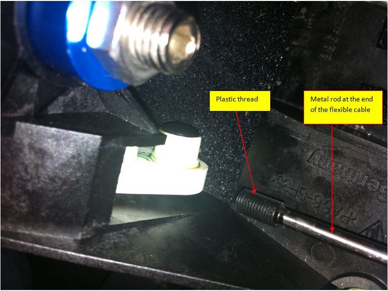

do not use this product.
the small Allen screws that supposed to attach it to the cable, are a joke.
the inner diameter of the part, is not even close to the size of the cable.
in my case the end of the cable was plastic, so adding the part ruin the thread.
it is almost impossible to adjust after installed.
i'm replacing my transmission cables this week, putting back the plastic part that was perfectly good when removed. ill replace it in 10 years if needed.
that was one of the most stupid things i did on my car, "while i was in there" doing the short shiftier.

it is not that complicated to build a nice sifter linkage. the only thing they needed to do, is to make the hole in the same size of the shiftier cable rod, withe matching thread.
in that case you will only have to screw it on, instead using the Allen screws.
the cable it self is flexible, and at is end, it has metal rod with plastic tread.
the hole in the linkage was too small to go over the plastic tread, and too big when the plastic part was shaved. maybe it will work fine with the "all metal" version of the cable. in the replacement cable i have, the tread is part of the rod, and made of metal.
on top of that, the socket it self (i don't have another word to describe the part in the linkage that hose the sifter ball) is very stiff, and you can feel it when moving the shiftier. once mounted, it is very hard to remove for fine tuning of the shiftier.
PM me your address, and i let you know the shipping costs by the end of the week.

yes, i am ewer of the adjustment screw. what i'm saying is you cannot adjust it when the linkage is connected to the cable on one side, and to the shifter on the other.
one of them needs to be connected. it is very hard to disconnect the linkage from the shifter, and messing with the Allen screws was a nightmare.
don't get me wrong, i got it to work, and i'm driving the car almost a year now with that setup. (ill post some pics of the design soon) i just think i can get better results with the OEM linkage, but will see about that.
BTW, once i decided i want to go back, i needed new shifter cables (destroyed the plastic tread on the original cable).
i found a set on eBay for 40$. now check this out...the cable i got from eBay is identical to mine, except the fact the tread at the end of the cable is made of metal (i will post a pic of that too).
