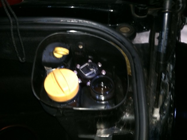

Hope everyone is well. Just picked up a gorgeous 2002 Porsche Boxster S, super low miles, and have issues to sort out before enjoying her. It's been bothering me dearly. I hope you guys can help me. I've done some research, but would love a confirmation.
I've been having moisture over-spray in the coolant area in the trunk. I read many threads, and saw that the caps were faulty. Currently have a cap with a ending in 447.01. I assume this is one of the older model caps? What's the latest cap that keeps pressure, and also doesn't allow overflow?
Today, right in the morning, I noticed that my temperature was higher than usual, above the 180 area. After some driving, and a lot of stop and go traffic, the Temperature Gauge blinker came on, and so did the "Check Coolant Level"
I've taken some pictures, to show today's events. I added some distilled water to the coolant, but noticed the gauge temperature is still above the 180 area which is bothering me.
1. Driving Home (At Night, "Check Coolant Level" Came On + Temp Gauge Warning)

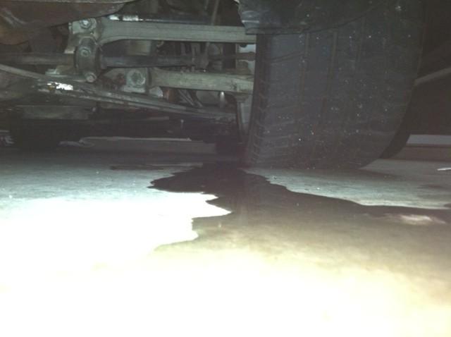

2. Arrived Home - Added Distilled water to Coolant Area. Turned on the car to see where the overflow was coming from. The coolant rises and falls off from the pouring area.
3. Anything look out of place to you gentleman?
4. After letting some of the coolant overflow from the cap, it drained out below the car.
5. Put the cap on tight, but noticed while the car parked inside the garage, the temp gauge was above 180 area. Didn't like that a lot.

That is where my temp stays. My guess is 195. The coolant leak and warning lights may be from a bad refill. These cars are a pita to flush, you may have an air pocket that is causing the spray and low coolant light.
Others will chime in that have more experience.Goodluck

1) temp gauge seems to be in the normal area. what made you think it shouldn't get above 180?
2) coolant level looks a little high in your picture. i don't know when it was taken - cool or hot. but when cool it shouldn't be that high
3) probably need a new cap
4) probably have an air bubble in there

your symptoms sound very similar to what I experienced a few months ago. I had the updated cap; my issue turned out to be the pressure relief valve. I replaced it and have had no problems since then.

i will also add that shortly after getting my new cap back when, i removed it for some reason or another. put it back on and went on down the road. then i smelled the coolant. opened the trunk and had the coolant in the same place as you. turns out i put the cap on wrong so even though it was "tight" it was not threaded correctly. i quickly learned to check it before assuming it's right.

+1. You're temp. looks the same as where mine runs. I had the same "mist" in my trunk area a year or two ago. Replaced it with the newest rad. cap from sun coast. Problem solved. $20 for the cap btw. Also check the relief valve. The coolant that you added in the pic. looks a little high. Wait until the car completely cools down to add. Someone more knowledgeable will chime in, but I think I read somewhere about driving around with the relief valve open for a few days to clear any air pockets???? Once again, someone who knows more could explain.

it's normal if the coolant / engine is warm when you open the cap. pressure builds up. it shouldn't be too hard to tell where the coolant level is just look at the "window", shine a light into the tank will make it easier to see where the level is. if you're checking when it's hot / warm it'll be up near the "MAX" line. when you're done with the drive, check the relief valve position. after a hard drive, mine is in the up position. as it cools down it closes.
also listen to the tank after it's up to normal temp. mine sounded like someone blowing through a straw - means there's a hole in the tank (or air is getting into the system).

I also find it hard to see the coolant level in bright sunlight, even with a flashlight, so I use a long fishing float (with string attached just in case!). Works very well, got the idea from my BMW which has the fishing float built into the coolant header tank.

2. On the Relief Pressure, there is a little silver hand, you bring that up to 90 degree position, it gets some of the air and bubbles out. The tech did that for me.
3. We topped it off with Porsche Coolant
4. I added the new cap
5. So far it has been ok! I was told, some moisture is fine and to check frequently.

I found that it is very difficult to get the cap tight enough by hand to seal well. It seems that the rubber seal causes some friction as it starts to seat and makes it difficult to turn.
I was having similar symptoms, and I lubricated the rubber seal with soapy water, which allowed the cap to turn another 30 - 40 degrees of rotation, and sealed everything up fine with no more mist / condensation on the trunk lid, and no leaks.
