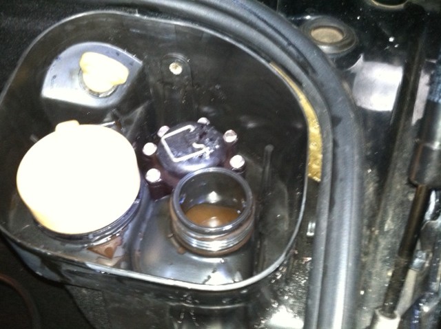

Hello,
Hope everyone is well. Just picked up a gorgeous 2002 Porsche Boxster S, super low miles, and have issues to sort out before enjoying her. It's been bothering me dearly. I hope you guys can help me. I've done some research, but would love a confirmation.
I've been having moisture over-spray in the coolant area in the trunk. I read many threads, and saw that the caps were faulty. Currently have a cap with a ending in 447.01. I assume this is one of the older model caps? What's the latest cap that keeps pressure, and also doesn't allow overflow?

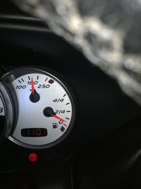

Today, right in the morning, I noticed that my temperature was higher than usual, above the 180 area. After some driving, and a lot of stop and go traffic, the Temperature Gauge blinker came on, and so did the "Check Coolant Level"
I've taken some pictures, to show today's events. I added some distilled water to the coolant, but noticed the gauge temperature is still above the 180 area which is bothering me.
1. Driving Home (At Night, "Check Coolant Level" Came On + Temp Gauge Warning)

2. Arrived Home - Added Distilled water to Coolant Area. Turned on the car to see where the overflow was coming from. The coolant rises and falls off from the pouring area.
http://986forum.com/forums/attachmen...1&d=1332477009

5. Put the cap on tight, but noticed while the car parked inside the garage, the temp gauge was above 180 area. Didn't like that a lot. :mad:
http://986forum.com/forums/attachmen...1&d=1332477024
wvboxst3r 03-23-2012 04:34 AM
That is where my temp stays. My guess is 195. The coolant leak and warning lights may be from a bad refill. These cars are a pita to flush, you may have an air pocket that is causing the spray and low coolant light.
Others will chime in that have more experience.Goodluck
tonycarreon 03-23-2012 04:47 AM
1) temp gauge seems to be in the normal area. what made you think it shouldn't get above 180?
2) coolant level looks a little high in your picture. i don't know when it was taken - cool or hot. but when cool it shouldn't be that high
3) probably need a new cap
4) probably have an air bubble in there
John99Boxster 03-23-2012 04:54 AM
190-195 is normal.
madmods 03-23-2012 04:57 AM
HOT car, Lucky you ;)
All normal beside the steam. Change the release valve o-ring first and see. Cap would be next. Go Porsche pink coolant 50/50 with distilled water and hit the traffic buddy

Kianfar 03-23-2012 06:57 AM
For the past week that I've driven this car, the temp stays at the 180 area, which is pretty much seems to be the exact center. Saw it at the 190's ish level and thought perhaps it was higher than the center, and something may have been wrong.
Does anyone know the part number for the cap? I called the dealership, and he tells me it's $80. Seems too much for a small little blue cap. Any online places you guys order your Porsche parts.
When I open the cap (The blue one), it has a nice suction sound to it. Could that be like having air in the system? It has a nice hiss, and I have to slow open it, until all the pressure is out.
tonycarreon 03-23-2012 07:51 AM
pelican has it for $28 + shipping
jjanari 03-23-2012 09:28 AM
your symptoms sound very similar to what I experienced a few months ago. I had the updated cap; my issue turned out to be the pressure relief valve. I replaced it and have had no problems since then.
jcb986 03-23-2012 10:08 AM
I would listen to these guys who have had the same experience as yours. Do what they tell you first. Cap and relief valve, cheap start. Flush and replace coolant next step. Also, you could have a water pump issue which is not totally uncommon for the plastic impeller to fracture. My 01S 3.2 liter runs around 185 and in the hot summer up to 195. Pelican Parts or Sun Coast.;)
tonycarreon 03-23-2012 11:24 AM
i will also add that shortly after getting my new cap back when, i removed it for some reason or another. put it back on and went on down the road. then i smelled the coolant. opened the trunk and had the coolant in the same place as you. turns out i put the cap on wrong so even though it was "tight" it was not threaded correctly. i quickly learned to check it before assuming it's right.
SeanZ4 03-23-2012 01:57 PM
+1. You're temp. looks the same as where mine runs. I had the same "mist" in my trunk area a year or two ago. Replaced it with the newest rad. cap from sun coast. Problem solved. $20 for the cap btw. Also check the relief valve. The coolant that you added in the pic. looks a little high. Wait until the car completely cools down to add. Someone more knowledgeable will chime in, but I think I read somewhere about driving around with the relief valve open for a few days to clear any air pockets???? Once again, someone who knows more could explain.
