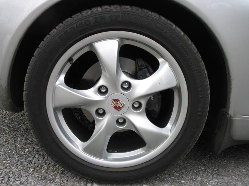

So I have to change my lug nuts on all four wheels. They are pretty rusted and on the driver rear wheel the nuts are looking pretty ugly.
So I went to some sites and the lug nuts are pretty expensive going for 8,7 and the cheapest ones i could find that are not Chinese were 6.85 each. So I did some more searching and came across these RSS spacers that bring there own lug nuts and the pair of spacers cost $65 any size from 5,7,15, and 18mm.
Got this from: Wheel Spacers for Porsche by RSS Hubcentric spacers black-Stable Energies
These means i can get spacers for all four for the same price as just buying the lug nuts alone. I have the stock sport classics 17in 205 in the front and 255 in the rear if im not mistaken. Wanted to know what size spacers you guys sugest? Does anyone have these spacers? Does this seem like a good price? I mean i looked around but sometimes someone else can find something better. I read that most people go with a 7 in the front and 15 in the back to get a flush wheel look. Let me know what you guys think.
Got this pic from:WTB: 17 inch Sport Classic wheels - Pelican Parts Technical BBS

I started with 7 front and 15 back with 17" OEM wheels but changed the front to 15mm as well, just looks better. For 17" wheels - 18" or bigger might be diffrent depending on offset.

I did like Andy, 15mm front & back on 17" wheels. I replaced lug bolts with chrome ones and really like the change as it gives the wheels a finished look that is missing on stock bolts. They look like there should be caps on them that went missing.

One thing I forgot to mention was to be sure to get longer bolts if you are adding spacers. They come in various lengths. Old Dan Gerous knows his stuff along these lines and I would recommend heeding his advice.
