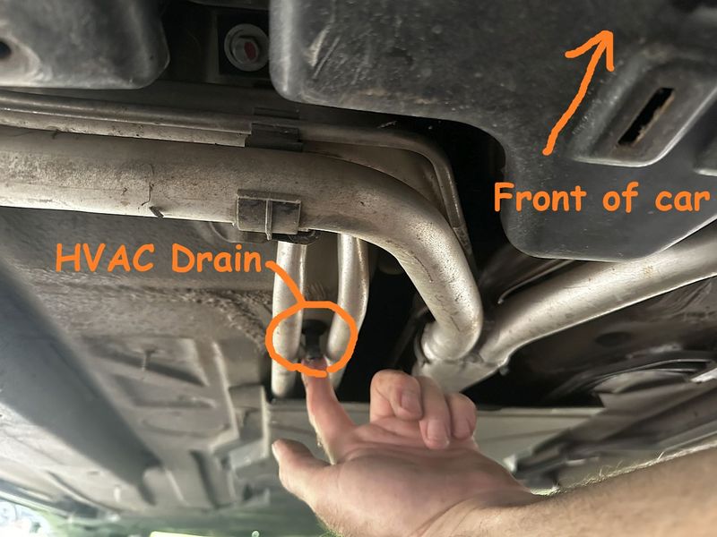

I wasted a lot of time working on the cooling system (heater loop). The metal tubes from the engine to the heater core both had some ugly welds on them that I thought were leaking.
I have some good tubes on hand and though it would be simple to swap them. It all went well until I had what I thought was everything disconnected and found that it was jammed between the gas tank and body. The gas tank has to be lowered at least partially to get the tubes out. Some day I'll do that, but this was not the time. I cut the 'bad' sections out of the tubes and joined them back together with some rubber heater hose.
I ran the engine for a while to warm it up and check for leaks. I found the leak. Not the tubes to the heater core, but the heater core itself. Coolant was flowing from the HVAC drain located near the front end of the heater tubing. I bought a new heater core that should arrive Monday. In the mean time I'm going to loop the heater system back to itself, bypassing the core.

In Other news, the '04 Special Edition had a low coolant indication while driving home from work. The drips looked like they were coming from the left front, but when I removed the front belly panel, I saw that the coolant was coming from the HVAC drain. I replaced the heater core a while ago with one that I had from a parts car. Since then I've learned that it's best to buy a New one. It's a lot of labor to replace - removing the front cowl, windshield wiper assembly, and battery.

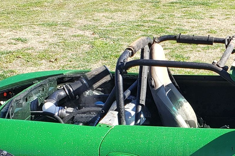

Is the 3.4 intake on the 3.2 motor? I can read back further if you have the info already shared. Thanks.
It's a 2.7L. Here's the original build: https://986forum.com/forums/show-tell-gallery/73877-6-months-live-build-thread.html
I bought it from Woody with a worn out 2.7L and swapped another 2.7L in with the same configuration.
996 ROW tune in the DME.
Holes drilled and tapped in the 2.7L head to mount the 3.4L intake.
Engine cover was cut and built higher with fiberglass to make space for the intake.
The exhaust manifold bolted on directly with the pipes to the muffler cut and welded. The ports on the head are noticeably smaller than the manifold.
I have a cone type air filter mounted behind the driver's seat. That location seems best to minimize dust when on a rallycross course.
It runs and revs well, but idle is a little rough when it first starts up.

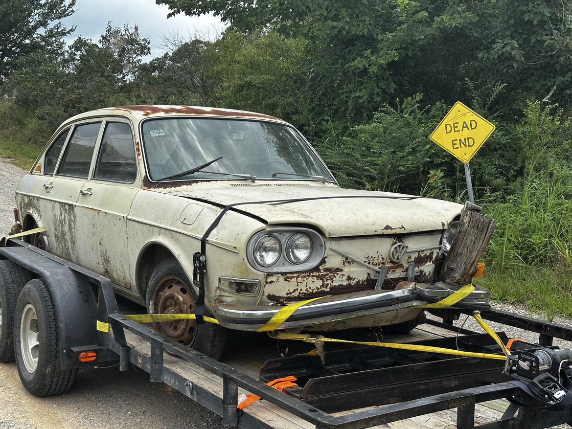

1981 Scirocco. I just brought it to my son in law's place for him to clean the minor surface rust and prime it. He is starting up a collision repair/paint business.
Yesterday I picked up a 1971 411. I'm most likely going to keep the engine and part out the rest. The body isn't terrible, but from what I've seen from the interior floor and channels it's not worth rebuilding.

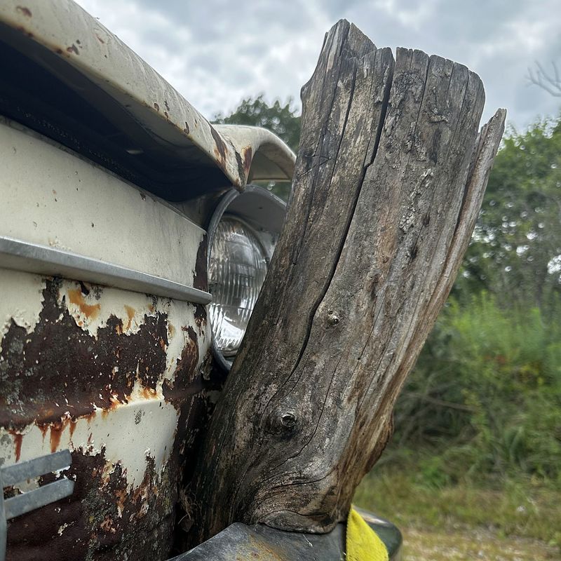

Seen better days but looks salvageable. What about the log? Let me guess: a tree had grown through the chassis behind the bumber and then at some point the rest was cut out?
Exactly. The car was last driven on the street in 1986. It sat in a field for most of the time since then. The tree grew, then was cut and left in place. I love it that way and may preserve it.
I'd like to get it running again just for fun, but there are a few cars ahead of it in line. At $200 I wanted to scoop it up before it was scrapped.

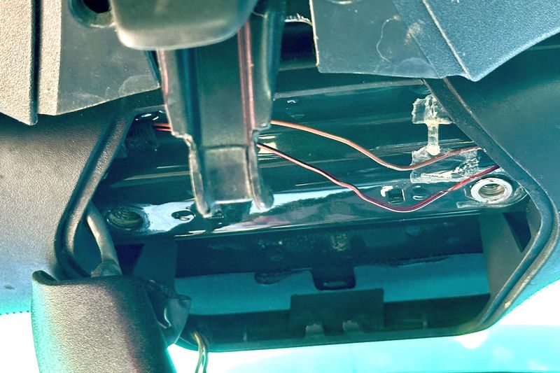

I got back to working on 986s when the '04 Special Edition had a check engine light for Major Vacuum leak in the evap system and the registration and insurance renewal came due for the black 2000.
The evap leak turned out to be a brand new fuel cap that wasn't sealing. Another case of why I should have bought a good brand part instead of the cheapest on Amazon or RockAuto.
The Black 2000 has a very long list of issues. I got it running back in April, then let it sit un-driven all summer. When the renewal came due I decided that if I'm paying for insurance, I might as well drive it. With a new battery, it cranked, but wouldn't start. It turned out that the fuel pump was bad. Replacing it was a little messy, but not too hard. The windows didn't work and fuse C3 was blown. That turned out to be a pinched wire at the roof latch shorting out.
The passenger headlight didn't work and that turned out to be a broken fastener that holds the headlight wire connector firmly in the tray - the headlight would slide into place, but not connect to the wire harness. Next on the list is figuring out why the parking brake doesn't work. The cable looks good, so I'll have to pull the brakes off and see what's happening. In the dark, the car doesn't look terrible.
No work done on the 411 yet other than finding that the entire wire harness has been chewed. I'm seriously considering putting the body on an '02 Suzuki Vitara that I picked up. Here's a Type 3 on a Miata chassis: https://dannix.net/index.php/lib/frankenwagon/finished How hard could it be..?
I see you also had issues with that thread that holds the bolt for that latch thing and is able to withstand a singe tightening on the assembly line. Such an annoying design.
