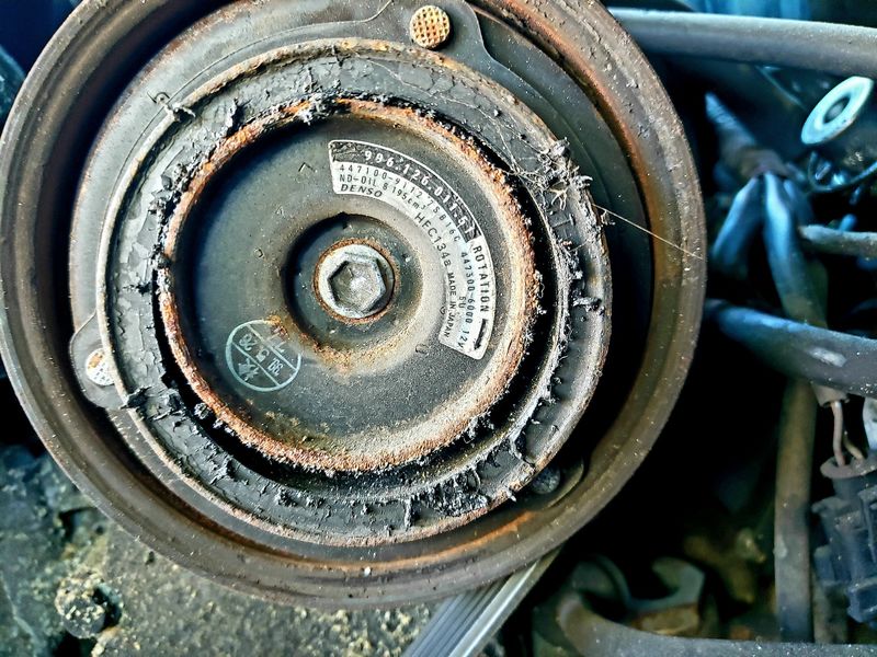

I opened the engine access behind the seats to disconnect some wiring. Add AC compressor clutch to the list of things to do if I get this car running. I do have a couple compressors on the shelf.
