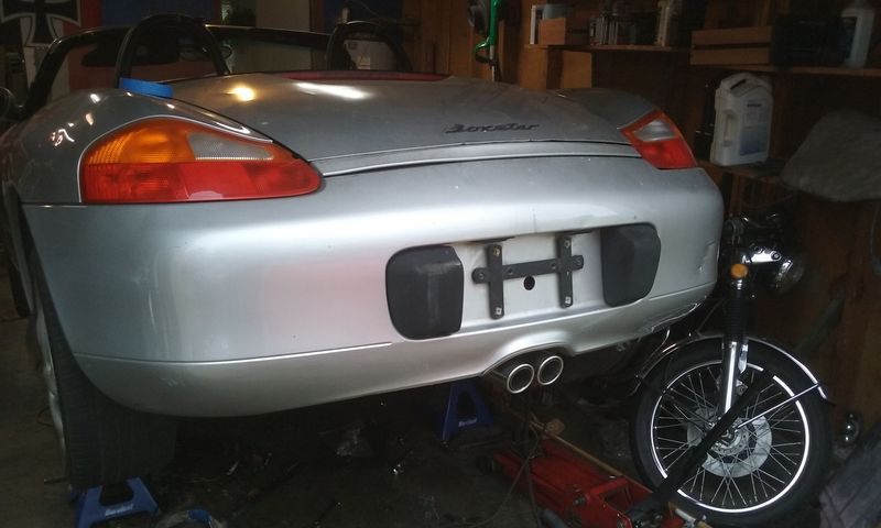

Ebay cat back, and cherry bomb glass paks. Should sound just like a Silverado

I'm curious about that motorcycle you got in that last photo

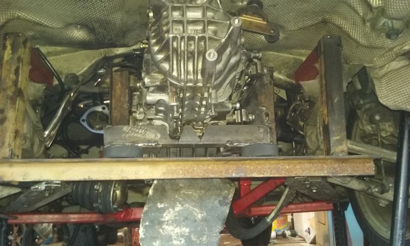

Old 03-22-2020, 03:48 PM   #44
Qingdao's Avatar
Join Date: Jul 2019
Location: Charleston
Posts: 571
She's my long time compatriot. A 1974 CB550. I used to do all kinds of buying and selling of motorcycles, you know "fliping". Don't find myself doing that anymore, but this bike has stayed around. Its the best bike I've ever had; just the best all around.

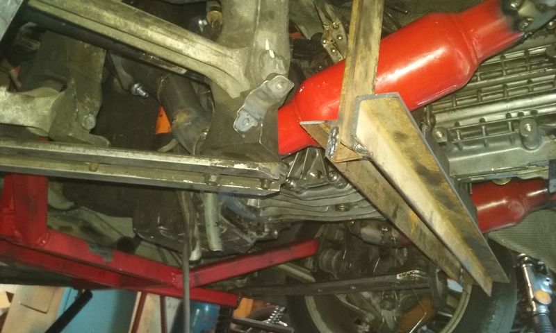

Finished hard mounting the cherrybombs to the trans cradle. Seems so weird not to hang an exhaust but the engine/trans move as one unit so does the exhaust.
And I started on my heater core return hard lines. As seen in red.

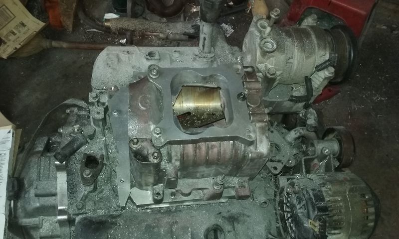

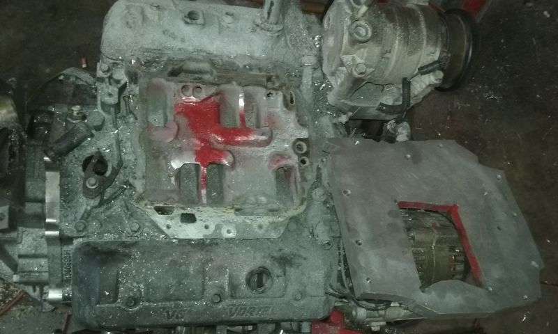

Posts: 571
Well, I just gotta say that I thought that getting the engine to fit in the 986 was going to be the challenge... BOY was I wrong. That was super easy compared to making a draw through M90!! But its done now
^^^ That's the 4.3's LIM
^^^ that is a 3/4" chunk of aluminium that has holes drilled in it.
^^^ there is the blower with a spread bore/square bore plate bolted to it.

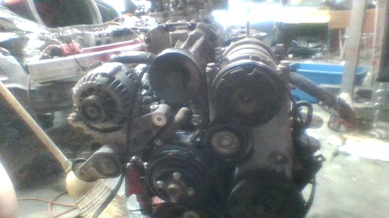

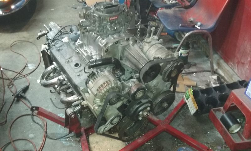

FINALLY done with fabrication/welding. (except for the A/C hoses)
The supercharger and carburetor are all mounted up. and the belt is routed... note the poor picture addendum LOL
^^^^ that's a stock idler pulley... I just happened to find a little hole in the ac bracket that had just the right threading and just the right spacing to make for PERFECT supercharger belt wrap.

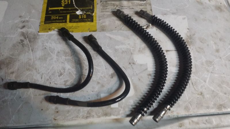

Got some new brake hoses in the mail... and installed them
^^^ don't think the old ones were bad, but I'd rather not risk a caliper over 20 mins worth of work.

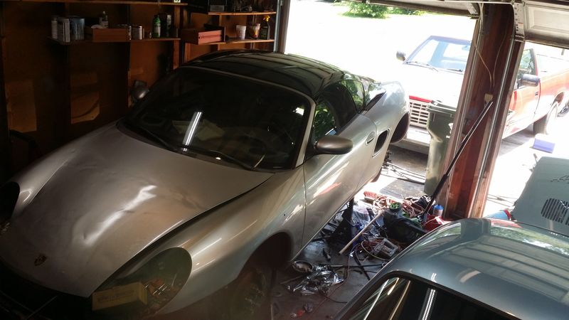

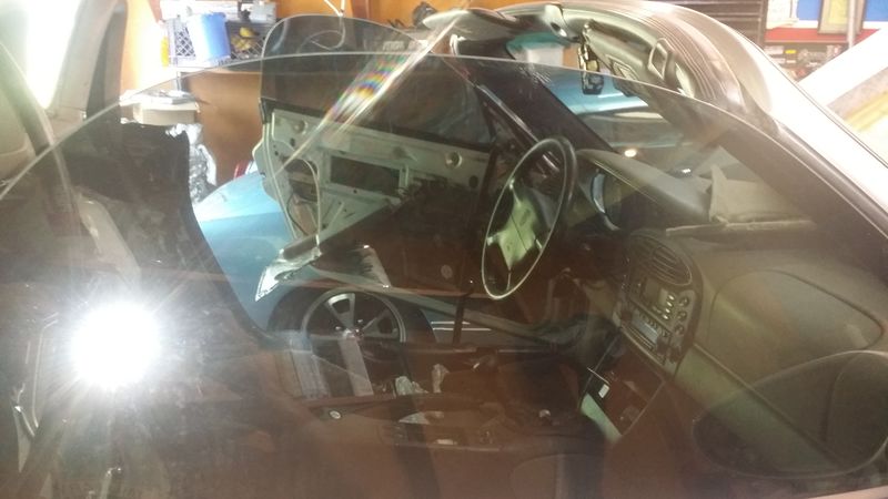

I finished mocking up my plexiglass rear bulkhead. I'm supprised how well a 24x48 inch sheet fits back there. If I didn't have a super tall engine I coulda almost just run strait 24 inches of height.
Ya'll got any tips on cutting plexiglass??? I got a plexiglass specific jigsaw blade, but I'm open for words of wisdom or experience.

Old 07-18-2020, 05:43 PM   #58
WillH's Avatar
Join Date: Feb 2015
Location: QC
Posts: 415
No pro but we cut it on a metal shear, bend on a brake. Use wood or cement drill bits and tape before. Main use for me is making machinery guards. Ymmv...
Old 07-18-2020, 06:51 PM   #59
Qingdao's Avatar
Join Date: Jul 2019
Posts: 571
Should I keep the protective wax paper stuff on while I'm cutting or should I pull it off and tape the lines I need to cut?
Fortunately other than a weird contouring cut along the roof line I don't think I'm gonna have to bend it at all. I also got special plexi drill bits. I'm excited to learn a new fab skill.

Old 07-19-2020, 02:01 AM   #60
WillH's Avatar
Join Date: Feb 2015
Location: QC
Posts: 415
Keep the protective film/paper/plastic on until you’re ready to install to keep it from getting scratched up. Use tape if it’s bare. Go slow with the drill and blades.
