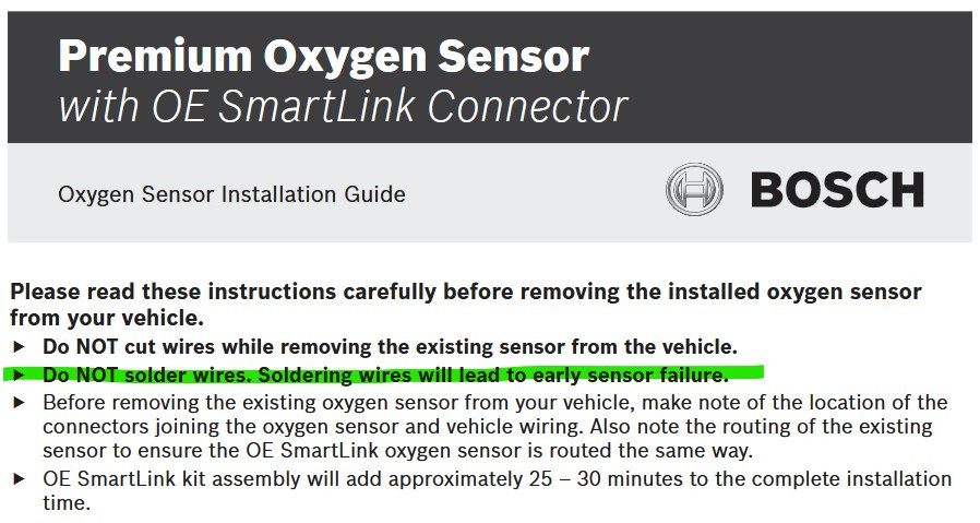

I have the utmost respect for your expertise. I looked into this issue when replacing all the oxygen sensors, as I wanted to use universal sensors and re-solder the original connector. I followed these (akward) instructions instead. I understand that everything must be sealed against water, so a shrink tube used for a soldered or crimped connection is a must and stabilizes the connection in addition.
In the end, it’s the result that counts, whether it’s soldered or crimped ;-)
Edit, Link not working, picture instead

Bosch uses microscopic air gaps in some of their O2 sensor wires to pull in the reference air you referred to, so if you cut the sensor wires very short to the sensor itself, soldering might cause an issue. But as the wires that come on the sensors without proper harness connectors are many inches long on purpose, soldering them away from the sensor will not cause an issue as there is still plenty of "breathing" wire still left. Over the years, we have soldered more than a few Bosch sensors that came without a proper harness connector, and we have never had a problem.
I am also aware that some aftermarket sensors use a type of wire that has a high nickel content, and which the manufactures recommend against soldering because it is very difficult to get a good solder connection high nickel wire using commonly used solder unless you use a special type of solder and flux to make the connection.
