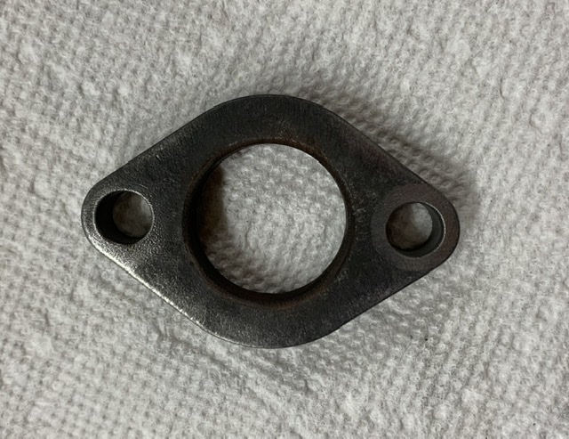

I discovered a shorted wire where it entered/attached, and consequently burnt the wire on a sensor on the right side of the block. It has a 2 pin connector and a flange/collar that secures it via 2-10 mm bolts. It was very easy to unplug it, and the aluminum collar came right off. But the 5/8”-3/4” diameter sensor itself will NOT pull out of the bore it lives in. Very odd. I’ve tried pulling it using pliers, vice grips etc..
1. I have no idea what it “senses/monitors”.
2. No idea what the part is called.
3. Most important how the f*ck to extract it!
It rotates a bit , but will not pull out!
Any idea what it is, part number and how to remove it?

That's the variocam actuator. You will need a set of timing tools to replace this. It's quite a task to change this with the engine in the car as it will require removing bank 1 to access everything. May as well have the tensioners and pads replaced as well if going that deep.
